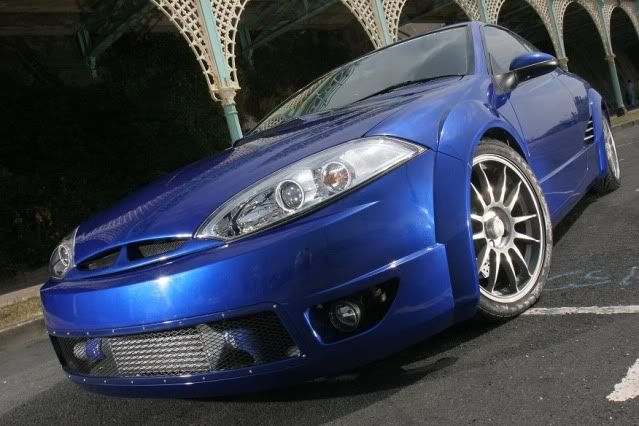

No, completely different car. The blue supercharged Cougar (known as 'Thundercat') was, as far as I know, sold to someone outside the club a good long while ago. Again to the best of my knowledge, that same person returned the car to standard and sold off all the tasty bits. The Cougar that Paul sold to the Ferrari guys was black and fairly standard.
ah!! that's a pity as the few photos I've seen of 'ThunderCat' look blooming marevellous - the 'S' kit looks particularly tasty
That car (or rather practically everyone he paid to work on it) caused Paul levels on turmoil that I don't feel worthy to describe. I think it's fair to say that after tens of thousands, the car was never finished to a level he was happy with and it more or less broke. I'm sure Paul would be happy to tell you all the good and bad point about it. Whilst impressive when it was actually running, it's not a car many people would want to have as their daily driver. It returned around 15mpg on average after the engine work, and the Emerald ECU had no cold running programme so it ran like a bag of nails until it was warmed it. Then it was unable to pass an MOT and had to be detuned a bit. That in itself was another episode Paul had to fight through with the now defunct company who did the engine work. That they're defunct is a good thing, because they also worked on RichB's car and he has his own strong views on them. The bodyshop who built the kit did a decent job of that but made a complete RS of painting the car several times. The company folded too and was reborn. They fitted the same kit to another car and painted that. This time they painted it ok but fitted the kit wonky. The actual owner of the car refused to see it, but anyone with vaguely functioning eyeballs could see one of the wheels wasn't centred in the wheelarch. Oh, the first incarnation of the bodyshop also fitted a kit to Kingroderick's car and resprayed that, but all the paint bubbled and flaked off round everywhere they'd bonded kit to metal.
Tread very carefully friend - all in, you could sum up the efforts of all the vendors involved in Thundercat as a complete clusterf---ornication.

Paul certainly proved that 348bhp from the Cougar could be done using the 2.5 litre engine. It had new pistons and conrods (memory is hazy here but I think the set of pistons cost £900 and the set of conrods the same), a higher capacity oil pump, and the whole engine was blueprinted. I don't know what injectors were used. The supercharger was a belt driven centrifugal type branded as "Procharger". It used a large intercooler as well. The gearbox was an MTX-75 which had been rebuilt and fitted with a Quaiffe limited slip differential. I can't remember what brakes he used, but I seem to remember him saying he wished he'd just spent a bit more and got Wilwoods instead. The car had the BAT 21mm rear anti roll bar fitted. Engine problems were poor running when cold, very heavy fuel consumption under light load and heavy emissions accordingly (the reason it was wound back to 250bhp for MOT and, I think, because Paul wasn't sure if the engine was really going to last that long cranking out 350bhp).
The bodyshop are, I think, what really hacked him off and ultimately made him throw in the towel, although the engine people (Autocraft SVE) were a bunch of crooks themselves who didn't really know what they were doing but knew how to charge money and at least one point held the car to ransom over a dispute over what Paul (and us) considered he'd already paid for and them feeling like being paid twice for it.

I had the leather door cards and dash made for Thundercat and they were a copy of the Lamborghini design. They were the dogs danglies. In fact they were the only bits on the car that caused Paul no problems.

I don't think the 'S' kit is an option with the company that made them going bust.
One of the guys who worked for them may still have the moulds though but with all the bad blood that went with these kits he probably isn't interested. However he did do a small production run of the 'S' spoilers last year.
Your best bet would be to find one of the three cats that have the kit (easier said than done);
- Shagmonkey's if the shell hasn't been crushed
- KingRoderick's - loads of corrosion on the rear arches and it's a Zetec so ripe for a turbo. Don't know who has this car now.
- CJSnet's with the wonky rear arch. I believe he's emigrated from the UK but before he left he wanted silly money for it (£10K). Don't know if he sold it or put into storage. The base car for this was a C2 ATX.
Rodders actually sorted the body work out on his before selling it on. IIRC, it was bought by a lad in Bristol who is a member here but can't remember his username. Think he's in the army actually.
