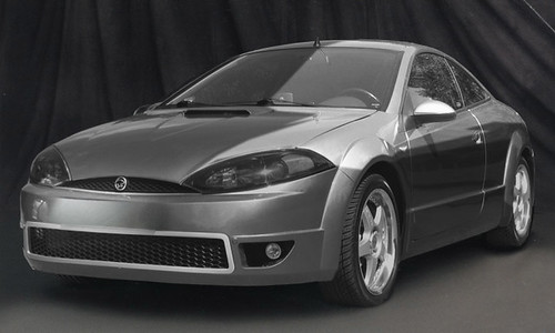

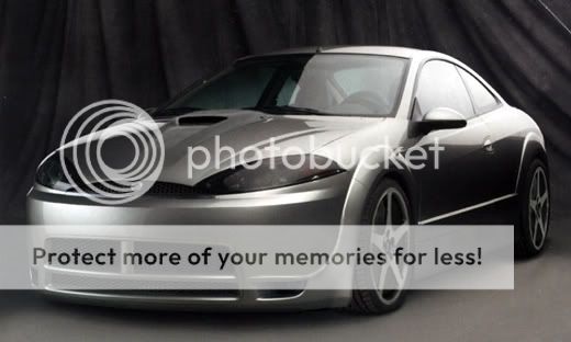

This a picture of the concept car it's based on i believe, tried to find a picture of Christians (CJNET'S) car but cannot find one.
It's a left hooker so it's a PS. IIRC, CJS was a bit of a photoshop wizard and was good at creating false images.
That picture is a bastardised version of the one and only actual Cougar S.
I have loads of pictures of both Christian's car and the original S-concept.
