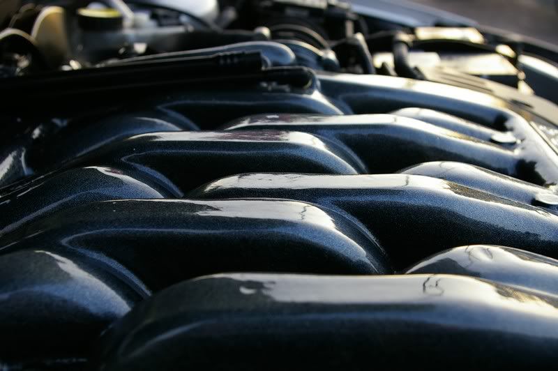

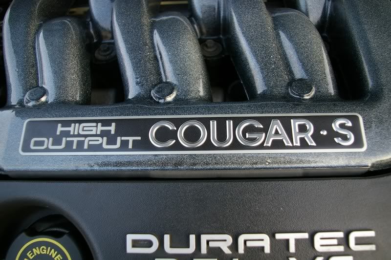

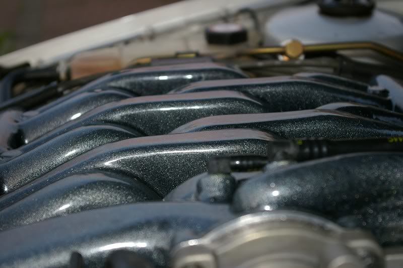

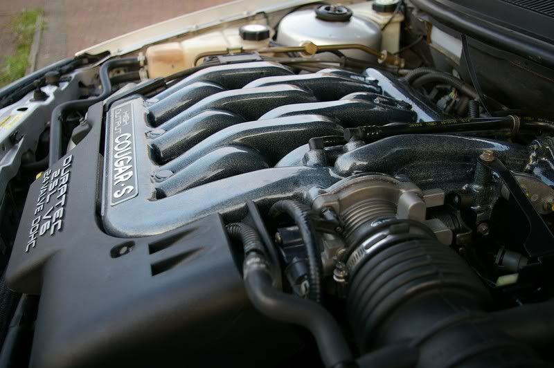

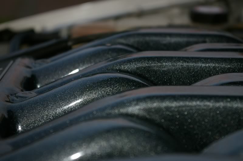

All together the bits were well over ?ú500 but I've been accumulating the parts for over a year.
The break down...
UIM ?ú200 from the US
TB ?ú130
Bellows ?ú7.50 (about ?ú76 new from Ford :shock: )
Airbox ?ú20 (about ?ú120 new from Ford :shock: )
Airbox bracket and rubber coupling to inner wing ?ú20
UIM blast & powercoating ?ú70
'Cougar-S' badge I forget now
K&N panel filter ?ú35
Gaskets, TB cable + bracket, vacuum pipe connectors, air temp sensor, bolts, sundries etc. about ?ú80 all new from Ford.
Tony's labour - some cash and a bottle of Vodka. :D
As for a group buy, that will be difficult as most of the parts were purchased on ebay and don't come up very frequently. I don't think the SVT UIM is available new any more but if it were it would be about ?ú600-?ú700.
I also spent the best part of a day cleaning the UIM and polishing the paintwork plus a few hours cleaning the TB.

Cracking job Manos, it was only a piece of junk lying in your boot last time I saw it :wink: looking forward to the `official` unveiling on sunday.
Gloucestershire is a bit far for me Rich but it is a beautiful part of the country.
Cheers Phil, yes fortunately the the junk has been turned into a useful and attractive peice of kit.
Wow, looking fantastic Manos!!! The finish on your UIM is really really nice! and glad you agree on the subtle and deeply satisfying induction noise!!! :D :D :D
(Every time i see some quality work being done it gets me motivated to try and do some more jobs on mine!! so thanks for the extra inspiration :lol: :lol:)
