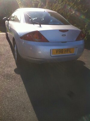

Cleaned her, and decided I was fed up with the state of the glass.
Used Megiuars Perfect Clarity inside and out and then used Angel Wax H[SUP]2[/SUP]0 on the outside. It's a ridiculously expensive coating that's a bit like Rain-X but sheds things like bird poop and dust and... well basically everything.
Tracey swears by it on Jinxy - so you know it must be good - but I'll let you know how I get on over the next week or so. It'll be interesting to see how the wipers cope since proprietary coatings usually fox them.

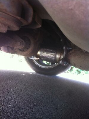

Had a knocking start recently from under the rear.
Had the chance at the weekend to investigate.
Thankfully neither the exhaust or suspension components seem at fault.
Have tightened as best I can the bolts holding the offending item, the rear towing eye bracket!
