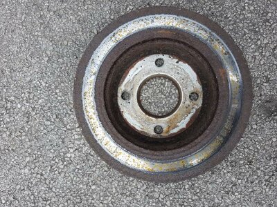

I noticed the rear brakes making grinding noise the other day so thought new pads were needed, upon closer inspection I found this
Now the last time I changed the rear discs on my black cat I had a nightmare and it took me 2 1/2 days to get the bolts out , so after buying what I needed I got everything ready - grinder, drill , blow torch, plus gas and all the other tools needed.
The bolts were the original ones but I remembered what Mark said when we did makos rear end- he said put the torque bit in and give it a bloody good belting firstly to seat the bit and secondly to cracking the rust.
I did exactly what Mark said and it resulted in both sides being done in an hour and half, I could not believe how smooth it went.
Pads changed and shiny new discs

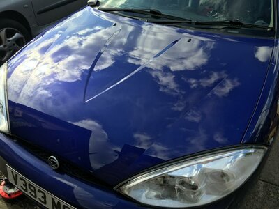

Last weekend before blackpool, ofcourse that means cleaning time:
Tried out the G3 Clay mitt & meguiars ultimate compound, must say I am really impressed!
