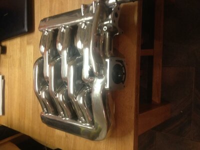

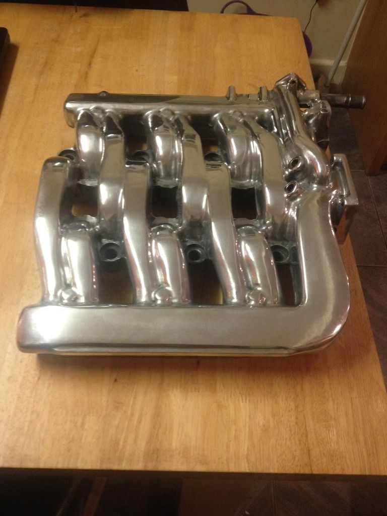

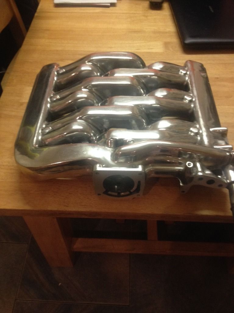

just got this delivered today ready to fit......:drool:....:drool:..

What's that then Paul?
it's a surprise Al.......grrrrr why can't I post pictures..... even when I manage to, they end up being upside down....:angry:..
I can see the pics in the thread now, can anyone else....????
