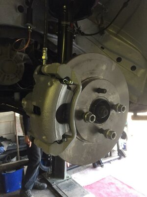

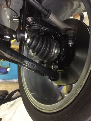

View attachment 7604View attachment 7605
Started on front brakes,drive shafts and suspension:thumbsup:
That is looking sweet. Nice job.

oohh im gonna be attempting this..any recommendations.
firstline.co.uk i got the parts from and very nice they are too, in fact on inspection we found them to be better than what we took off.
dont forget to put a little drop of thread lock on before fitting and make sure your breather goes back proper for the bellows
