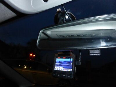

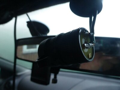

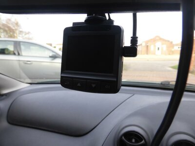

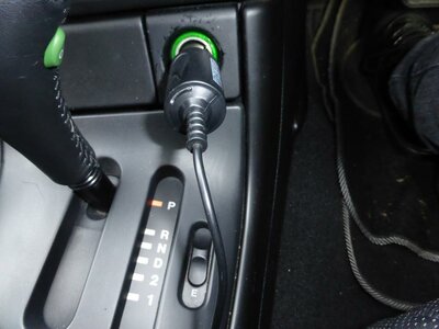

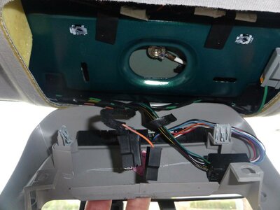

Automatic dashcam hidden feed
I have a dashcam since the car before Cougar Zetec.
In Cougar Zetec I had hidden the power wire, behind the passenger A-pillar trim, plugged into a twin accessory socket (also with hidden feed for sat-nav) behind the lighter socket, but which was still plugged into the lighter socket.
As such this was still unsatisfactory with the lighter socket permanently powered meaning the camera had to be unplugged when stationary.
Considering a neater solution for MV51, and after discovering in Zetec a cavity above the courtesy lamp I decided to fit a single accessory socket there, knowing it could get permanent 12v from the map lamp feed. This would also free up the lighter socket.
Earlier I asked if there was a switched feed in the vicinity (MV51 has the extra warning lights console there) and @FlamencoAssassin helpfully informed me that the sunroof loom socket is there; this shares fuse with the power windows which only operate with the key turned, the ideal switching for the camera.
So soldered the accessory socket (removed from a coiled extension lead) to the cut wires from the sunroof feed, pushed the camera's mini-USB power cable out between the headlining and windscreen, wound up the excess cable and stowed above the courtesy lamp.
Photos; 1 & 2: the dashcam fed direct from lighter socket, with cable draped over rearview mirror
3: with the lamp housing removed, warning lamp console hanging before unplugging, sunroof socket (green and black wires) just visible pegged to inner roof skin at right
4: accessory socket soldered on instead and
5: reassembled showing camera powered via key switched feed.

There is an easier way in which to do this. There is a kit on the market that allows you to solder a spade connection (fuse blade) to the end after you cut off the 12v plug. This then plugs directly into a spare fuse locater which is only live once the ignition comes on. I have been looking at this myself, as I too use a dashcam in my car. However, because I 'm not good with electrics, I'm going to buy the kit and then have a mobile auto electrician come out and sort it for me.
I'll see if I can find the link to the kit. Well done for the work you have done on yours anyway, seems like it does much the same thing, just in a different way.

What I like about my method;
It utilises an existing wire that runs the "difficult" part of the path;
Whether a sunroof is or isn't fitted, you can still tap the feed (obviously a little more work if there is a sunroof);
Am using the original dashcam power adapter, no need to purchase a hardwire version of the same - indeed it allows to replace the dashcam with a different make/model.
It has been pointed out that the new socket is "protected" by the power windows/sunroof 40A fuse, I will adjust my setup to include a smaller value bullet fuse right before the socket to avoid the 40A blowing in the event of PSU fail or unintentional short.
