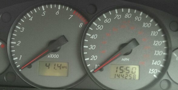

Well just finished sorting Gems Cougar, traced the rough running down to the Throttle Position Sensor, changed that and now running beautifully, last week on her way to college the near side front Abs reluctor ring decided to snap and fall off, so that was my main job for today, luckily I had a spare so after chiselling off the remains of the old one got the replacement hammered on and then decided to fit cruise module as I had the wheel off so that's all done and back together, found a hole in the front of the sill so got some welding to do but need to practice first. Changed the pedal switches for the cruise ones and now waiting to see which wheel Gem plumps for and will then have a cruise control kit for sale![]()
