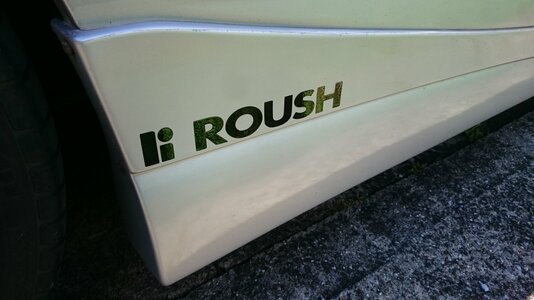

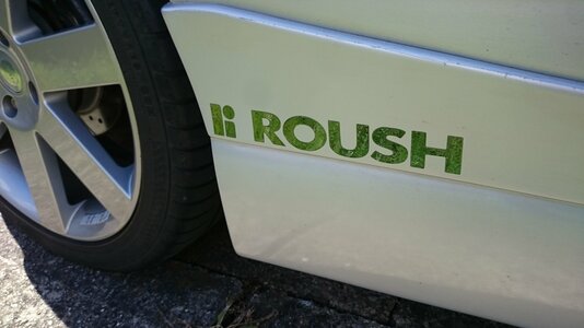

Today, i decided to update DG's ROUSH decals. I really like the black chrome ones i did for Ricky so off came the old CF effect ones and on with these. Really difficult to show the effect of this black chrome as it just reflects :), hence the green grass effect but take my word for it, these are not green. :lol:
CLICKY for full size.

I like the 2nd one better where you can see all that grass rather than just parts of it[emoji1]
Looks good though

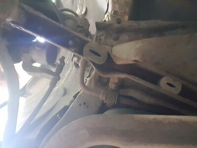

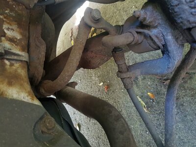

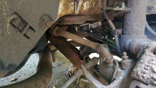

Got two new rear wheel ABS sensors today, but, they would not fit in the hole. They are identical to the old ones apart from the diameter of the shaft that fits through the knuckle. Didn't want to waste money buying another type, so, I bought a 15.5mm drill and made the holes bigger. Jobs a good one.
Jacking points were a touch less inviting,
Fine. I'll jack it on the beam. Crunch. Car came down to put the tyre back on the concrete, Jack still fully extended.
Widow maker and hammer to straighten.

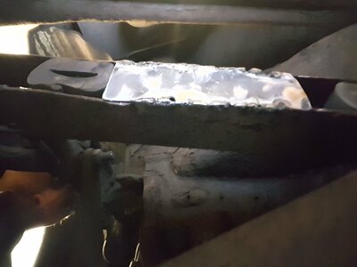

Arc in the dark, and by feel as the mask wouldn't fit under the car with me... Not the neatest welds but closes the box on the weak spot until I can find a supplier for trailing arms (not radius arms.. I was going to fit them..) and a new subframe... Speedbump tested at 80 on a closed circuit, solid. I was off to Chester zoo with my son the following day, wasn't leaving it to chance if I hit a pothole on the motorway.
Anybody know a reasonably priced supplier? Rang Ford and was told trailing arms don't even show up, and the crossmember is no longer available, price when last available was apparently £642 +VAT!
Sealed for now, but really want to replace the rusty crossmember and arms asap.
