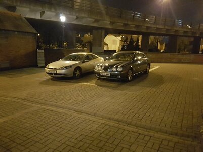

Emptied her into her replacement. Left a load of parts in that I just didn't have time to fit and sort her out.
Transferred her to a good friend who doesn't like them in the hope it helps him with his current transport shortage, as well as to understand why I rate them so highly.
I love the 4 litre V8 toy, but already miss how light, tiny, and chuckable the Cougar is.
Referral to UKC made, as well as keeping first dibs if he ever sells her on. I love the Cougar, but with work being so manic at the moment, the last breakdown costing me a weekend, and still waiting for a fuel filler pipe to be posted... I reached the end of my tether.
She's Matt's girl now.
Needs must indeed. He has a couple of weekends ahead to get her straightened out - she needs the time spent and I haven't got it. Onstreet parking only on a narrow hill doesn't help much either.
Stuck my head in the footwell of the SType to get at a fuse and found a Ford badge staring back at me. Lock and unlock it with the same fob I have on my MK6 Transit. I'm still in a Ford, really. Ford funded the development of this V8, too.
Enough of the right DNA.

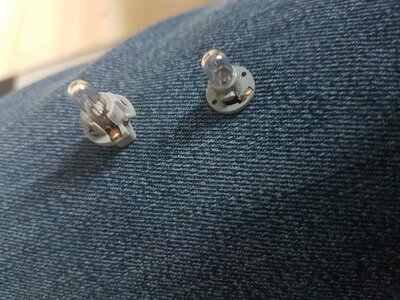

...Latest on this...under the aftermarket surround there were no removal holes, managed to wrangle the kenwood out anyway...discovered that the thieves had broken the heater control panel, all the lugs were broken off, so have replaced it with the one from my spare car, odd to see a chunk of grey in there...I'd forgotten they were a different colour...also discovered that if the lights on the heater controls stop working, there are no bulbs you can change, it's just a PCB in there, so I replaced that too...still have the light for the digital clock to fix...I hope it'll be easier to get at, and most especially a normal bulb!
Thanks again for all the advice... (y)
Good to hear you've sorted part of your problem but for future reference you should have found two bulbs in your HVAC control panel.

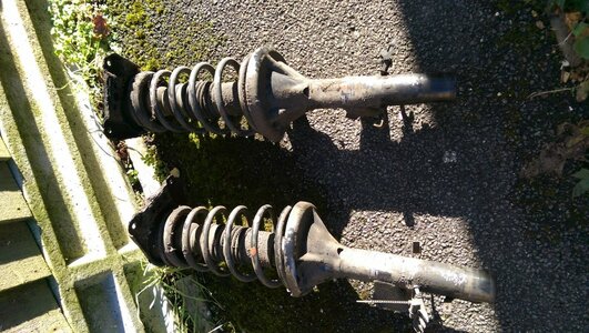

Stepped well out of my comfort zone today - decided I'd have a go at replacing my rear suspension.
So, off with the old:

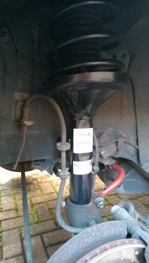

And on with the new:
Also polybushed the rear droplinks for good measure.
Only had time for a quick test drive, all seems ok for now. And I'm absolutely knackered :)
Good work Mart.
I was going to crack on with some bits on mine this afternoon but the back muscles weren't going to have it, so it'll have to wait til next week now.
Good going Mart, did you have any trouble with the bolts in the top of the wheel arch?
Your going to feel it in the morning from whacking the hub back in place :LOL:
I'm feeling it now mate! :)
I had no trouble with the bolts, every one came out with no fuss. Seperating the old shocks from the hubs and then getting the new ones back in was a total ballache though...
