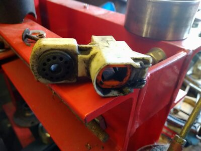

Is that red thing a bearing press perchance Al ?

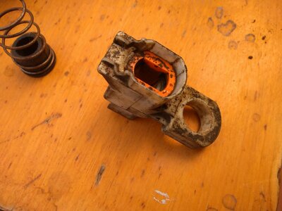

Tiger has also thrown that bush...over a year ago. I really need to find outwhether it's an orange or red one and just get on with it.

One of mine failed a little while. I'd noticed the gearchange had got sloppy and found the loose fir if the component whilst underneat doing something else.
12 ton press ! you cold do some damage with that. When you first got it did you crush things just because you could?

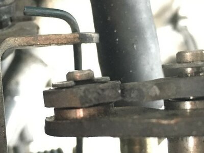

All going well aside from a concern over oil (I'll post about that later in my project thread), until I come to start it up and notice a distinct lack of feel in the throttle. Fires up and ticks over, but the throttle does virtually nowt. Under the bonnet and it revs more when fully open, but nothing before that. I remove the bellows for a better look and see this...
If not clear, that's the little plastic link on the throttle body that's snapped cleanly through the middle (the one that's like a figure 8). Basically it means I'm getting no opening of the TB now.

Here's hoping. So bloody annoying, just too brittle I guess. I don't mind doing the upgrade, it's in the plans, but the timing couldn't be worse. :rolleyes:

I'm now contemplating a Heath Robinson solution involving two cable ties.... o_O
