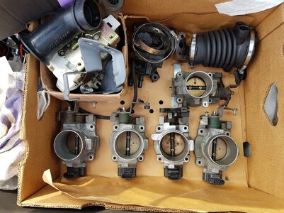

Anyway my boxes in the loft have yielded a fruitful harvest. Ready for some photos of the bounty?
ST200 TB and I assume appropriate cable? Came with the scrapper never looked at and chucked in a box.

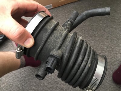

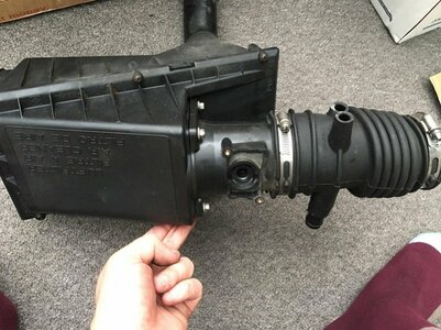

Airbox #1. I believe this is the ST200 one, although the bellows look different (or is that just me?). Also has one of those mesh filters inside.

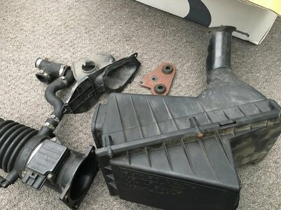

Airbox #2. I didn't know I had these, I think they must be ST200 too? Something missing from the top, MAF? Paper filter installed.

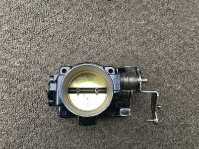

The bit that matters, a nice shiny ST220 TB. Oh what's that on the side...

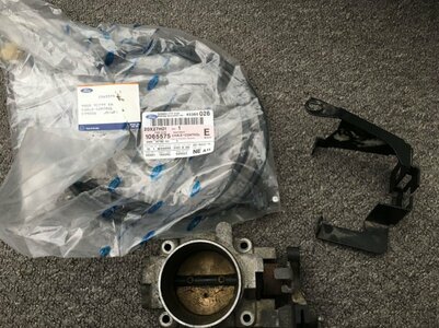

Boom! Looks the same so if it easy to remove, this may be the temporary fix, seeing as the gasket won't be here until later in the week it means I'm not stuck blocking the drive. This is important for the domestic relations.

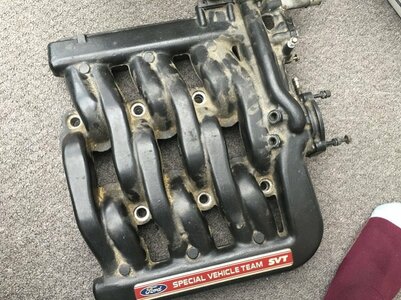

The ST200 UIM, bought at the same time as the scrapper. Have gaskets etc in the Box Of Doom along with other odds and sods, but that'll be for later.

Sam, the air temp sensor is on the bellows on the 200 version rather than on the airbox itself. Unfortunately the original connector won't reach it in it's new position so you have to either lengthen the wiring or cut a hole in the airbox in the same position as the original and bung the hole in the bellows.
You may also find the 200 bellows are slightly shorter than the original which makes refitting a bit of a trial. I found by connecting the bellows to the TB and the airbox lid with the lid removed I could get more purchase on the lid to pull it back into position rather than trying to fit the bellows with both ends loose.
There's a dilemma. I hate hacking things from the original when working but needs must.
What's the common preference, is there one?
As Andy said cut a hole with two tabs on the side of it to accept the air temp sensor.
Easy way to make sure you get it right is to look at your standard box and make a hole of similar shape ;)

Have you got the bracket to go with the st220 TB?
I did exactly that myself. Drill a hole in the box of the appropriate diameter, and then Dremel/file/saw the notches for the locating pegs.
The only difference is that I didn't need to bung anything - I used the standard ST24 bellows. I...um, don't recommend doing this unless you have a masochistic streak.
One last thing - and Tony will like this - please ensure that the mating surfaces of your UIM and LIM are scrupulously clean because otherwise you will have an air leak and a car that will not idle. Use a Stanley blade to scrape off the carbon, but for pity's sake make sure you don't scratch the aluminium. Use some sort of straight-edge - a steel ruler is what I used - to ensure you've got no gaps.

Cheers chaps, the UIM will hopefully be some time away as I need to sort the LIM etc out too. If I can get away with just the TB / airbox, that'll do for now.
It sounds daft but I want to spend any extra time sorting the sills out, the LIM and UIM will be a luxury I'll reward myself when the essentials are done.
Plus I may as well do the cam covers then too.

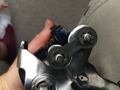

Just had a quick look thru my own collection to see if I have something. Several of these have the 'dumbell' shaped bit of plastic intact, but they are all 'lefthanded' versions off autos or other related vehicles I think. I don't think that part will have changed though. If you'd like me to post you one, I could do that in the morning - please PM me.
However, rather than waiting for a replacement, could you not just draw around it and fashion something out of a random piece of plastic after drilling a couple of holes ?

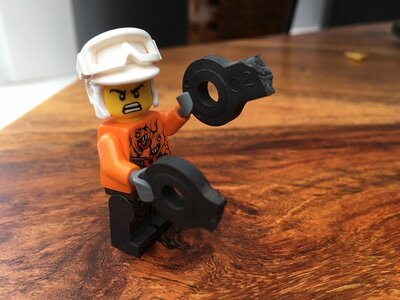

After breakfast I thought I'd see how easy it is to remove the dumbell from the 220 TB. As it tuns out it wasn't too tricky bar some radial retaining ring type things. Once removed, I replaced the retaining rings to keep those safe. I felt comftable enough to try it with the TB in place in the engine.
So far so good...
Under the bonnet, and with memories of dropping the throttle retaining clip fresh in my mind, a white cloth was positioned beneath and the retaining rings removed along with two halves of the broken dumbbell. Replacing it for the 220 spare was fiddly. There's no slack so it has to be slid over both posts at the same time which required a bit of accuracy in aligning the two. The retaining rings were awkward to install (I was glad that white cloth was there...) but careful perseverance paid off. Quickly fire it up and all is good! :)
I even timed it to the fifteen minutes between downpours. The offending article is pictured below
As you can see, Lego man is less than impressed with Ford for this.
Al, I was wondering thought if it'd be worth posting these bits to you, to see if a spare could be sorted with your 3D thingy-me-jig? I appreciate it does not seem to be a common problem (has anyone else's ever gone?), but having the capacity to create a spare anything shouldn't be overlooked?
