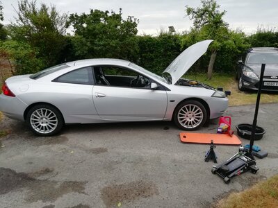

Oil and filter change today. Tightened up that bumper stay bar too so hopefully that will have cured that rattle. Checked plugs as per Dan's suggestion and all nice and tight. Also a quick spray round with the Waxoyl on the power steering pipes and bottom of front wings. Sump was looking very oily so hopefully a new plug and washer will stop any leaks, I suspect the sump gasket isn't quite what it was, but I'll live with it for free rustproofing.

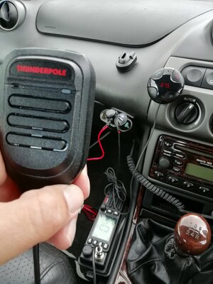

Radio, mic mount and multi power socket installed....
And aerial on temporarily for testing purposes, I won't leave this in place all the time, hard-wiring it is kind of beyond my competency:LOL:
The sticky pads provided to mount things like that to dashboards are utterly useless, even cleaning things with alcohol wipes beforehand wouldn't make them stick. Good job I've got some Araldite:devilish:
I think there's something about the texture of the dash that stops anything sticking to it. I installed some cable guides (for my dashcam) and they lasted maybe two days.
Not sure I'd take the Araldite route, but since I will never sell Wildcat, I might just do so for my own convenience.
