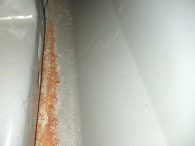

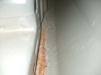

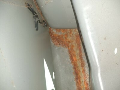

Hi All, Many thanks to Dabooka, yesterday, I de gunked the washer bottle as per his How to, today I thought Id try removing the sponges behind the rear door cards , thank you Shagmonkey for the How to, Ive only removed the off side and here are some photos of the inside, is this an unusually large amount of rust to find there? Ive sent off for some Hydrate 80 to spray on it , followed by Dynax 50s. Any tips on how to proceed are most welcome

Nah. Flood it (and the other side) with Bilt-Hamber Hydrate 80 or something similar and brush it around. Then once dry, squirt in the underseal of your choice.
Then do the same thing to her belly and arches. Lift each corner, remove wheels and arch-liners, and get insane with it. And, uh, wear gloves!
Ive seen much worse you've caught that just in time by the look of it... after putting the rust treatment on it id give it a paint with stonechip or zinc primer before spraying the dynax on it
