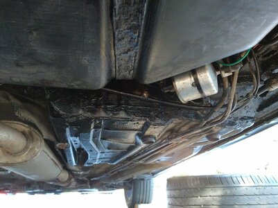

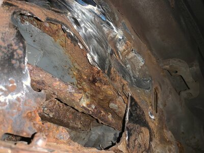

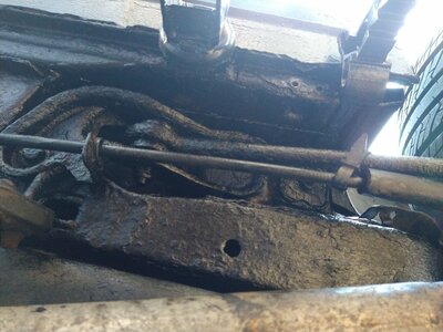

David, is that a jack and an axle stand located on the sill ? Wow your a braver man than me ! Even when my new sills are finished I wont be doing that.
That was 20 years ago. The sills rot at both ends first, then in the middle under the B post. I recommend lifting on the sub frames or main chassis box section.
Sorry if that sounds critical David, just trying to help. :wrong:
I'm not subjected to near the rust you guys are, and I have a dent in multiple of my cars from using that box section on the floor.
Unless it a car with an actual frame to lift from I wouldn't use anything under the car to lift anything.
Id never lift from the box section but I would place a Jack stand on it.
Lifting by the front subframe(I know some will disagree!) And the rear subframe is the safest way IMO then Jack stands on the box section or at the rear where the 'triangle' near the handbrake cables run
I don't like lifting from the front of the front subframe in case the car walks, jack slips, and pounds the cup through the bottom of the radiator. Seen it happen too many times and I've seen a Rover Tomcat's upper slam panel thoroughly destroyed because of it.
But lifting on the front or rear subframes in general, then putting axle stands under the "frame rails" (in quotes because they're not really - box-section is probably the best description, thanks Dan) is my preferred method.
To put it another way... it's your car, your informed risk to take, and you should lift it however you're comfortable with. I won't criticise and as long as we're happy that it's safely supported, we're good to go.

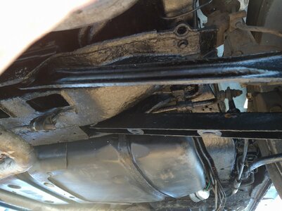

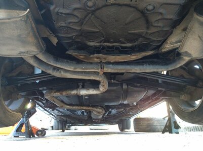

Back on lifting. I often use the trolley jack on the front subframe but on one of the main bolts to the rear of the front wheel. No danger to the rad, the jack cup would sit nicely around the bolt head but I never use the jack direct onto the vehicle. No matter where I lift there is ALWAYS a wood block in between jack and car to spread the load. I also lift on the front subframe, close to the wishbone bolts.
At the rear I lift on the subframe. I’ve placed 12 inch long wood blocks on the rear box sections with an axle stand underneath, the wood block spreads the load along the full length of the box section, I have no dents. :thumbsup:

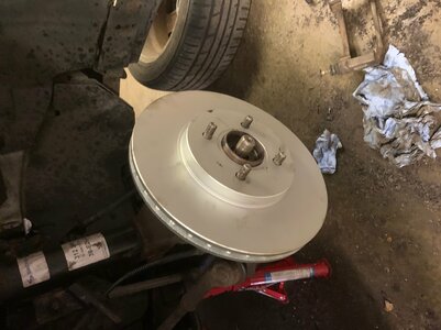

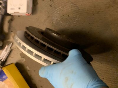

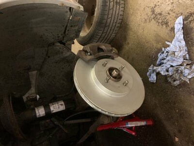

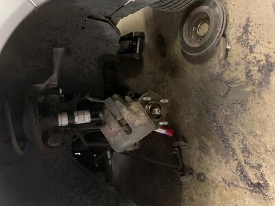

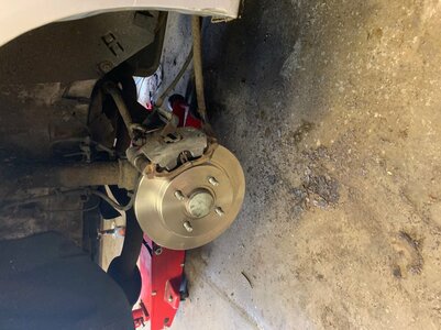

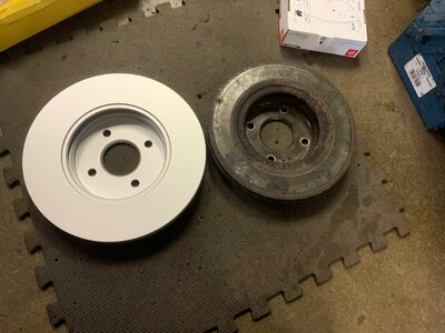

Started on the repairs for the MOT today, did the front and rear brakes, up rated brake set up on the front and new disc's and pads on the rear, along with some handbrake adjustments.....:thumbsup:.. a few pics.. the wrong way round for some reason....:thumbdown:.. so if anyone can put them the right way up, that would be greatly appreciated..
New bigger disc compared to the old one.
