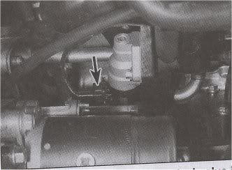

Pid_16V said:Isn't that the idle air valve thingy :roll: :wink:
Here it is on the zetec
Pid_16V said:It's a pig to get at matey
I got it, but my Cougar is still stalling at idle revs :x. Computer diagnistic may be necessary.lottysvdub said:did you get the thingy you were looking for ? its called an idle speed control valve![]()
lottysvdub said:have you checked for air leaks around the throttle body and inlet manifolds or any of the surrounding pipe work ?? could be worth a check buddy can be done very easily with a tin of carb or brake cleaner , have the car idling and carefully spray the carb cleaner around the throttle body , inlet manifold and all the vaccume pipes around the inlet manifold and the throttle body , be very careful not to spray near exhaust pipes or any other sorces of ignition , if the revs rise you have a leak at the offending item you have sprayed . hope this is some help![]()
