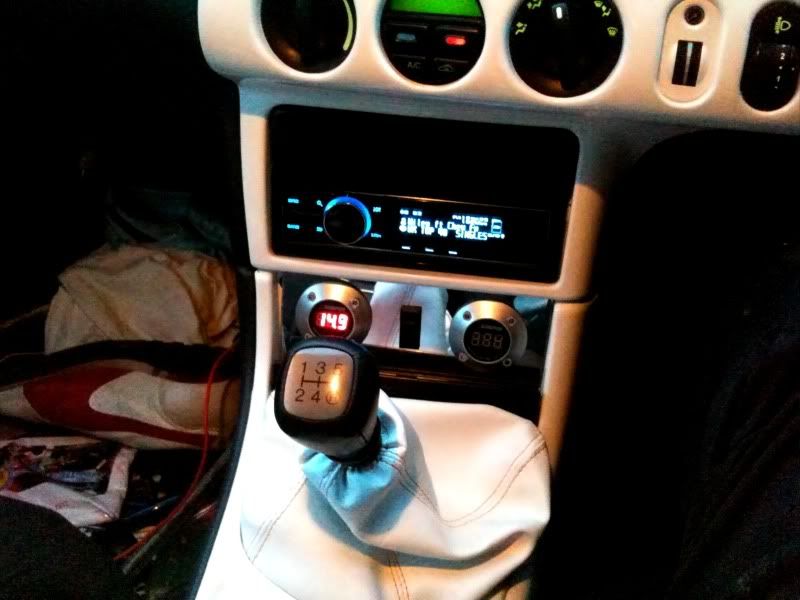

volt guages in one at rear near amps one at the battery bank overkill maybe but why not

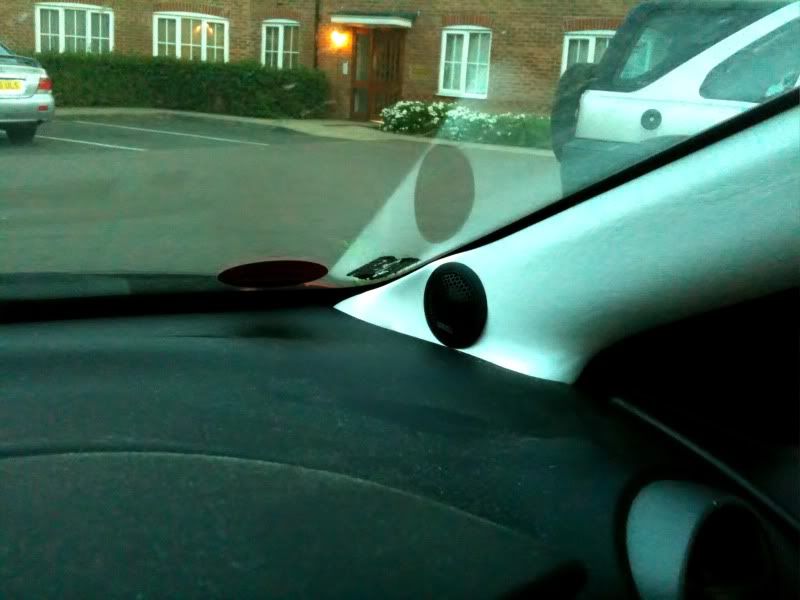

Tweeter location at base of A pillar

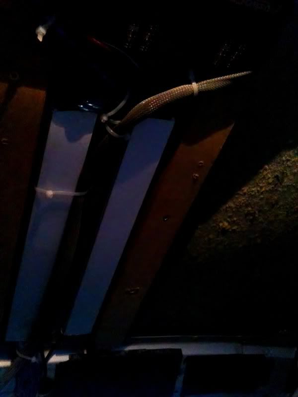

Roof wiring which is no where near all of it! lol sorry for the dark picture using my phone

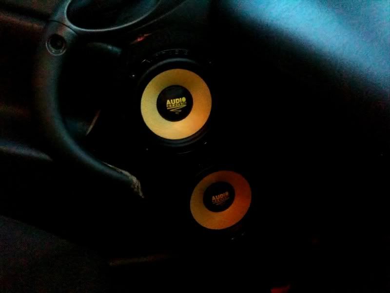

Doors another mid to go in and some trimming still to do but these speakers are bloody loud!

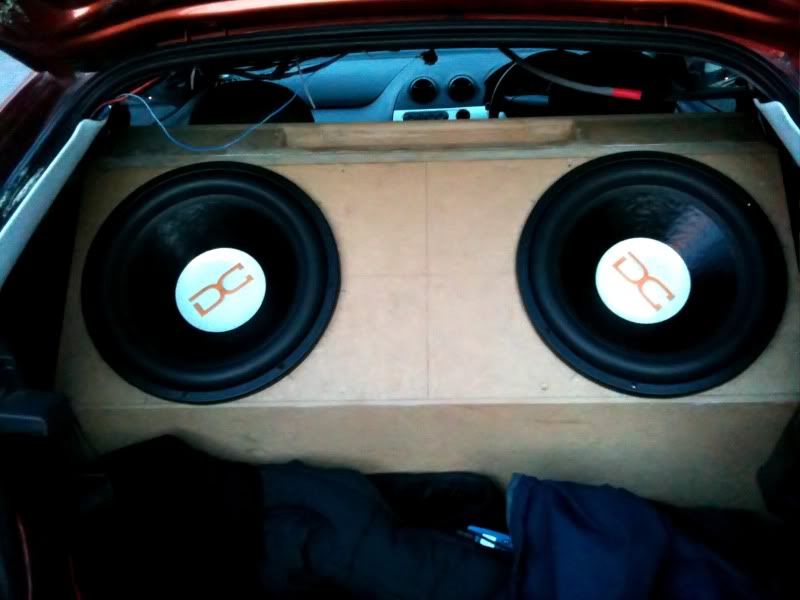

And finally for now the sub box well one of them there is another of these to go in and the sub box is not staying there it is a temp location till the other two subs go in.
