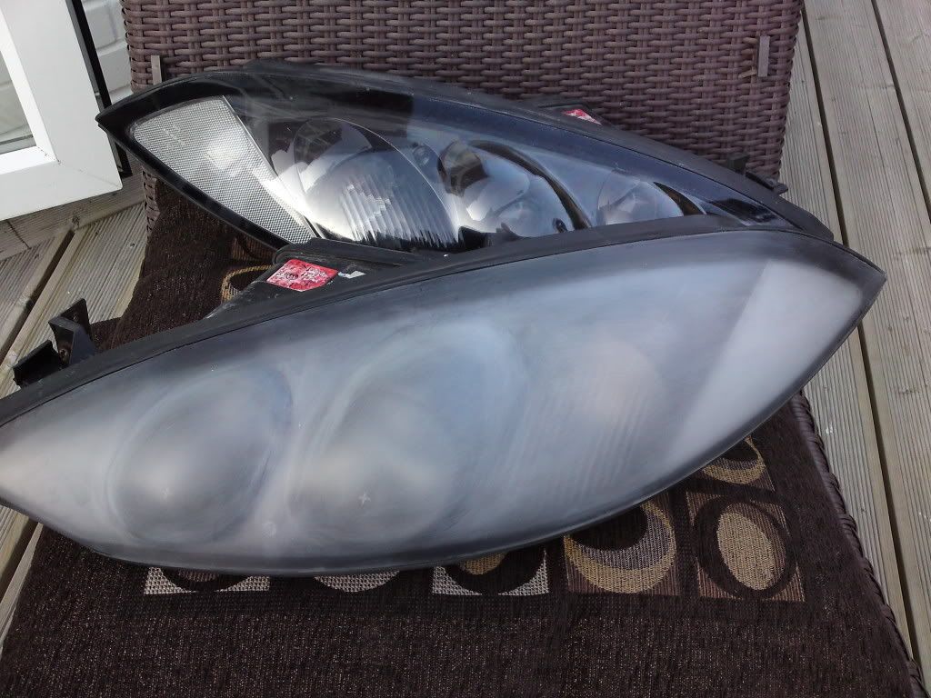

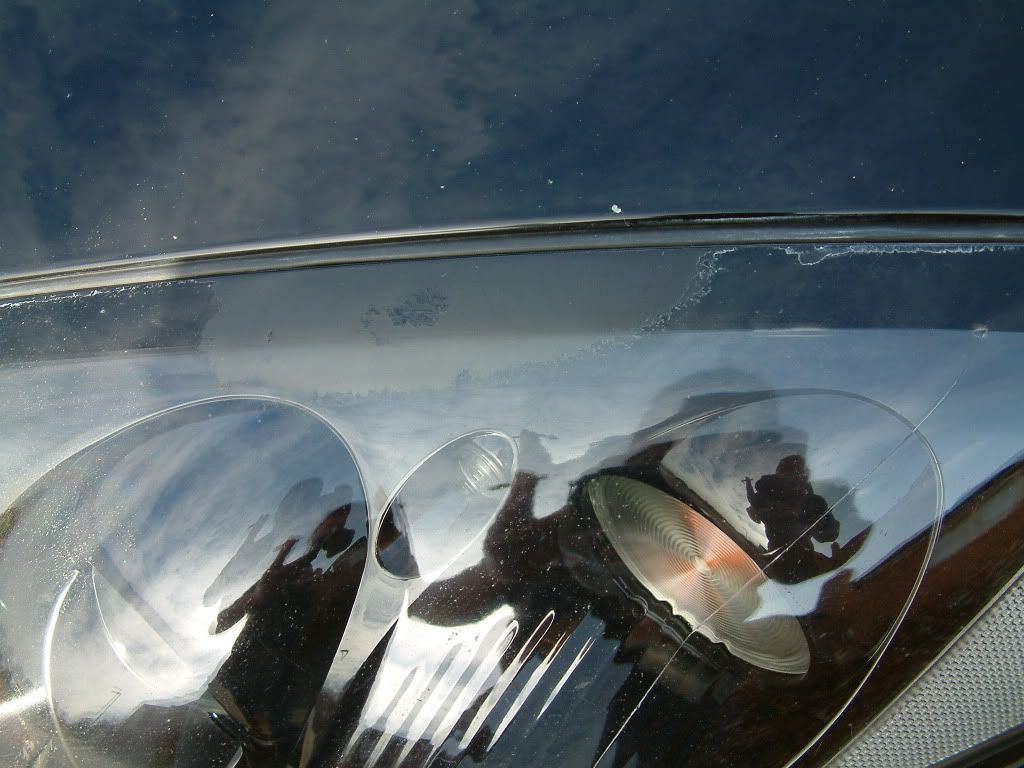

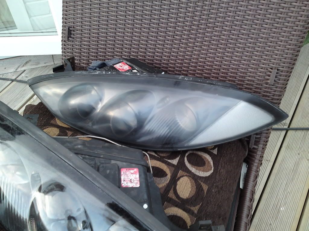

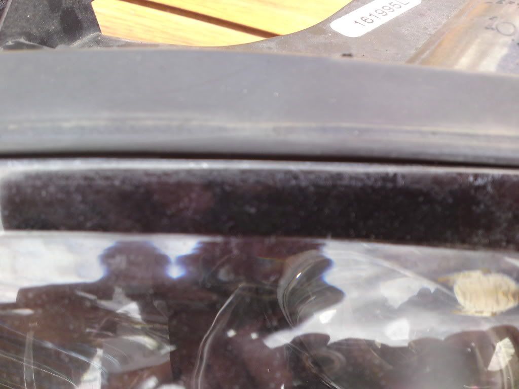

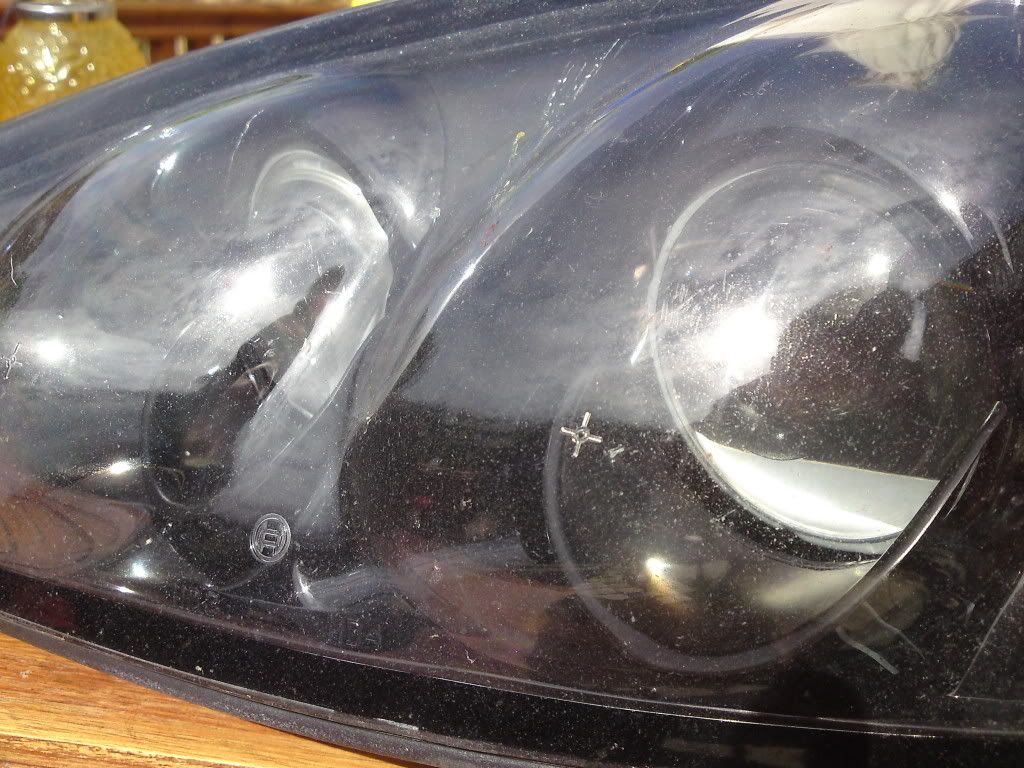

Well I kinda got distracted and everytime I looked at the headlight, I shuddered and did something else! :lol:
I mean, look at it :shock::shock:

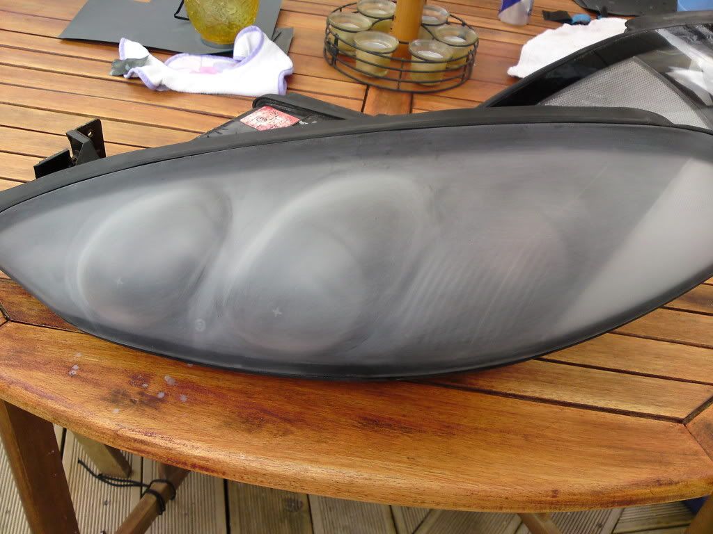

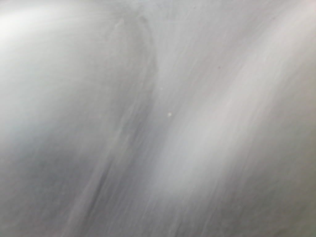

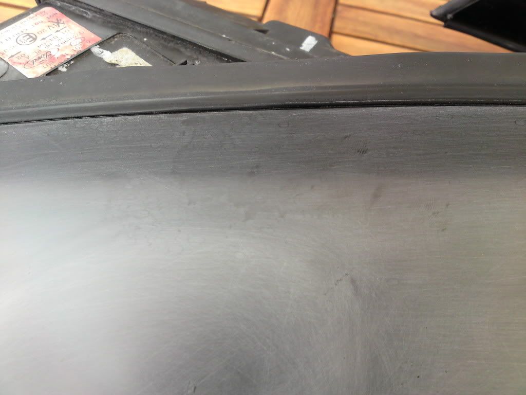

After some SERIOUS sanding...
Very deep stone chip. Can't sand it out as too deep...
Where the topcoat had been missing for so long, even after sanding you can still faintly see a mark. Lets see what it looks like after polishing...

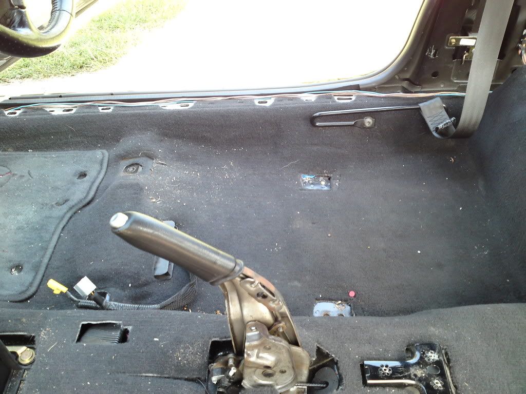

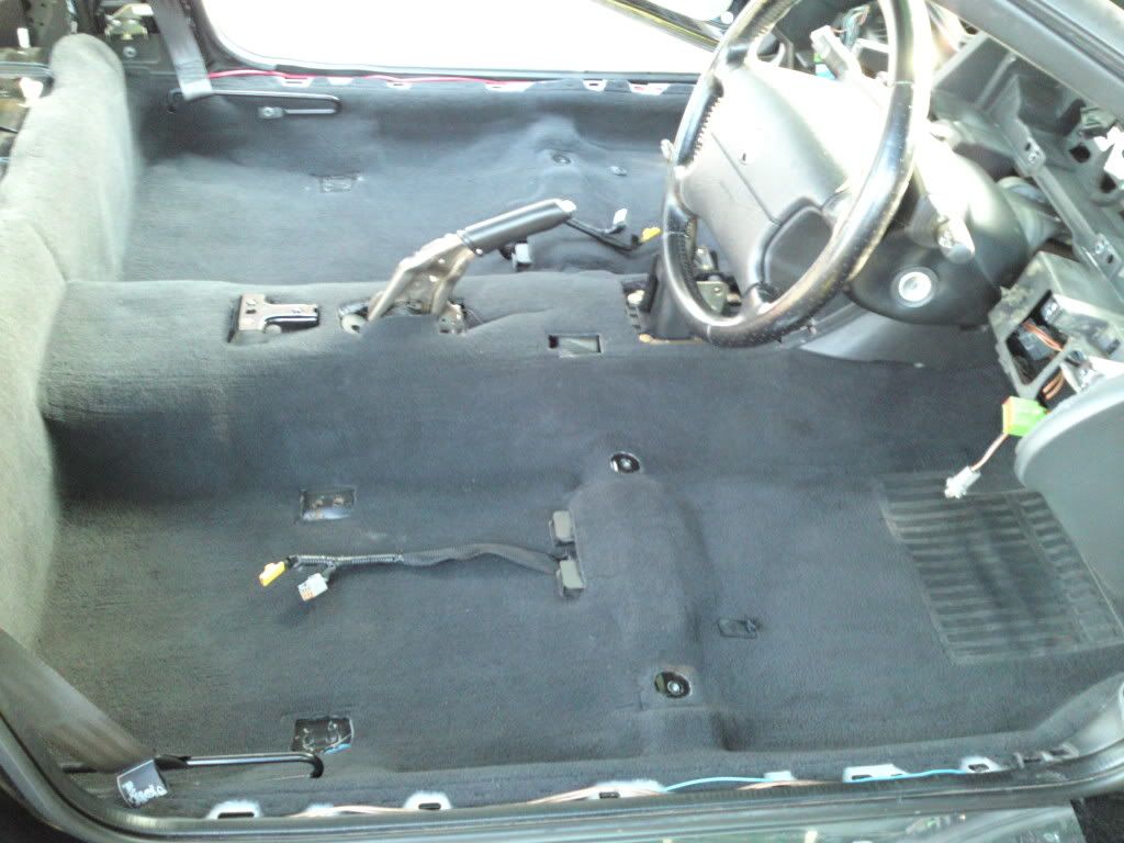

Anyhow, hoovered out the interior and the dash (it's amazing the **** you find behind panels etc) and got rid of all the pieces of broken glass.
Weirdest thing...and I don't know if there is something you want to tell us Alan, but I found 3 toenails :sick::sick:

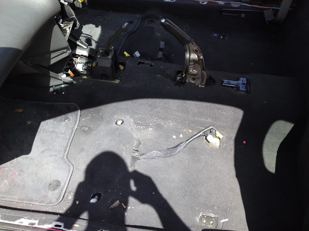

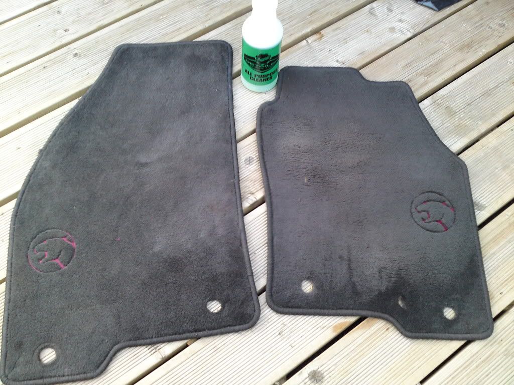

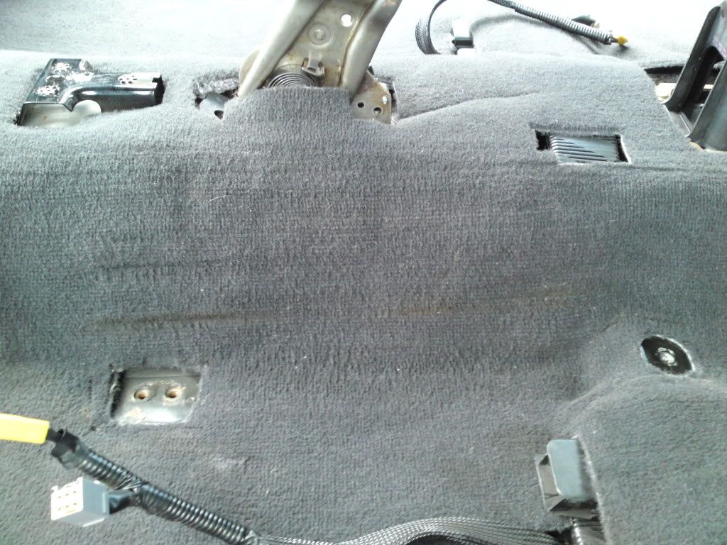

As you can see in the above piccie, there are a couple of lines of grease/oil in the side of the carpet. I treated these with a strong solution of Meguirs APC and after a fair bit of scrubbing, I got most of it out. See below...

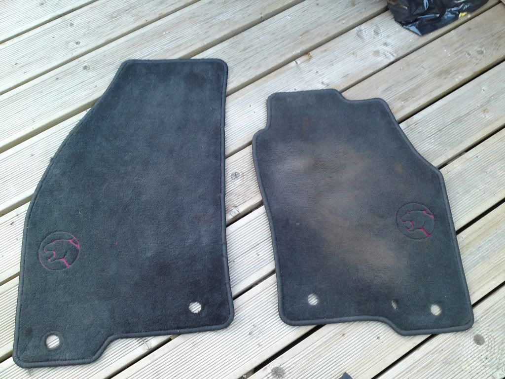

I then hoovered the floor mats (he only has front ones) and noticed the drivers side was also covered in oil/grease....
This was treated again and goven a good scrubbing. Didn't want to have to dig the vax out of the shed and tbh from seeing the results, I think it looks plenty good enough. I mean, it's a floor mat :lol: (It's still wet in the photo BTW)

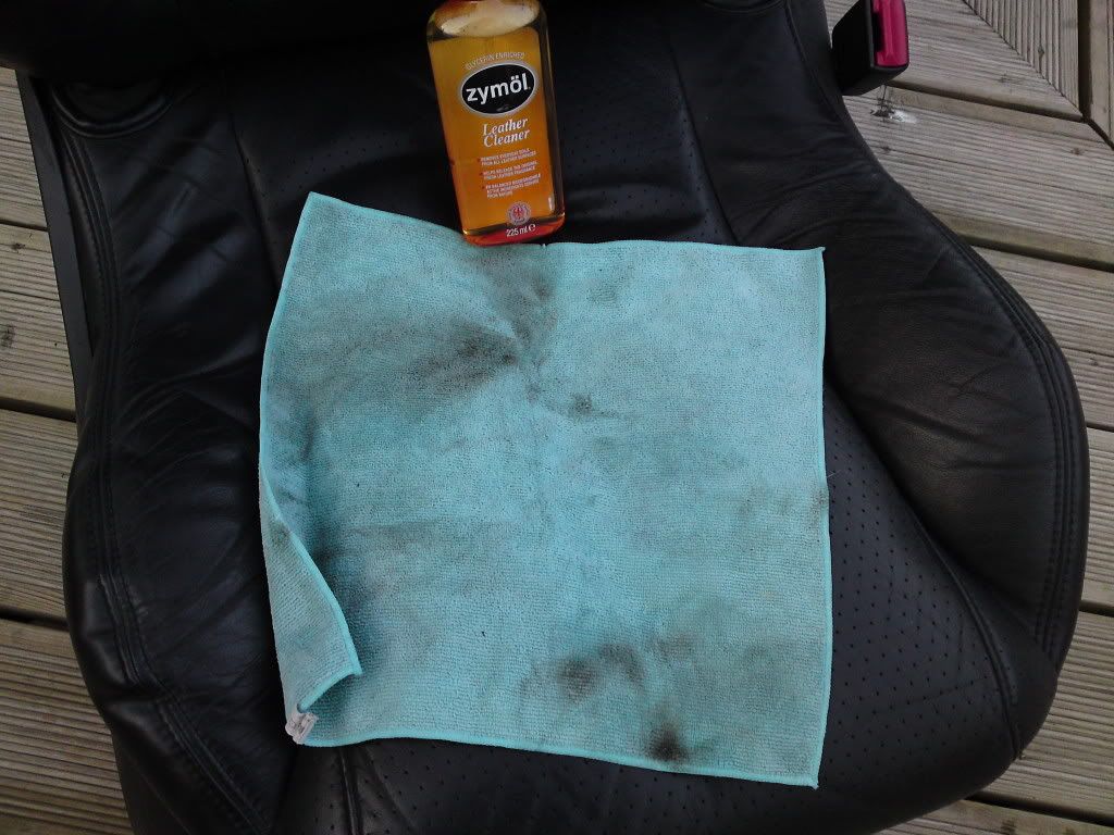

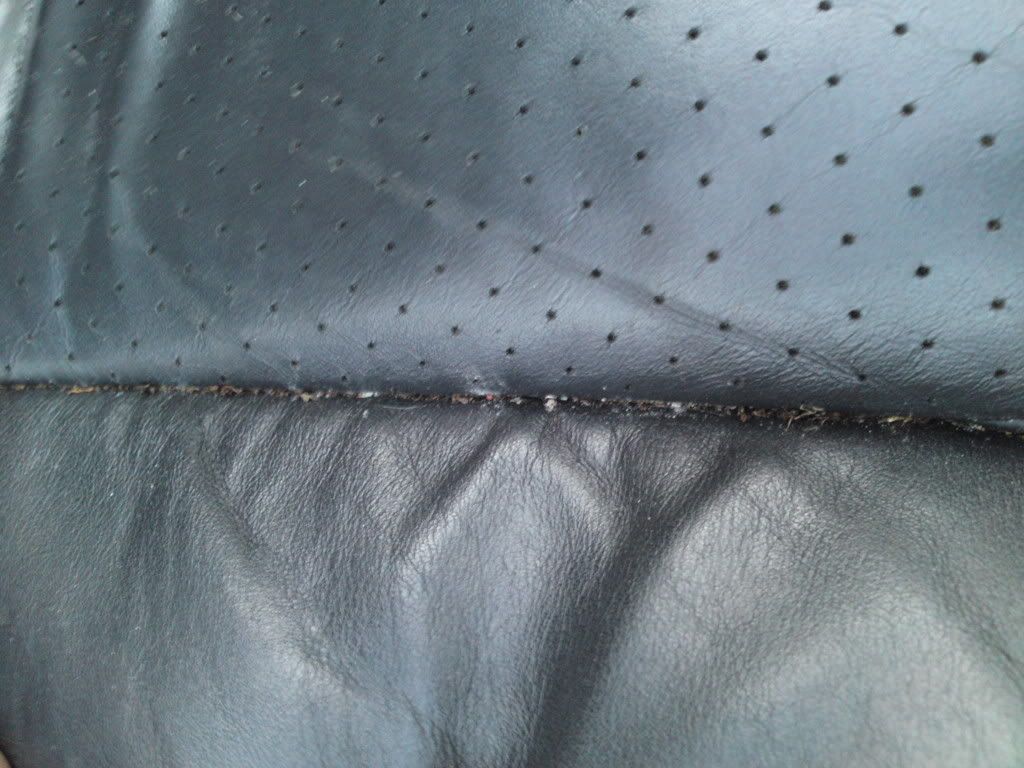

Leather seats were given a clean.....again....:sick:...using Zymol.

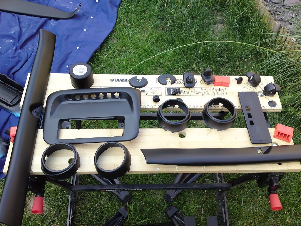

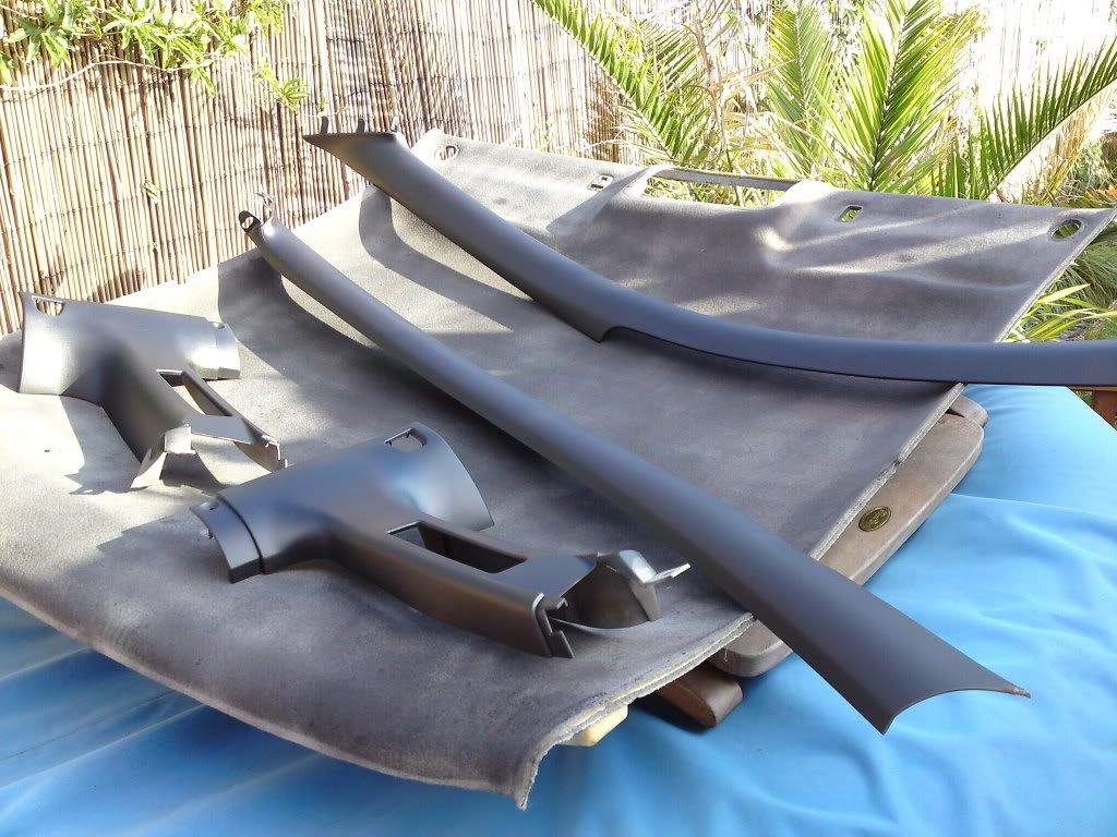

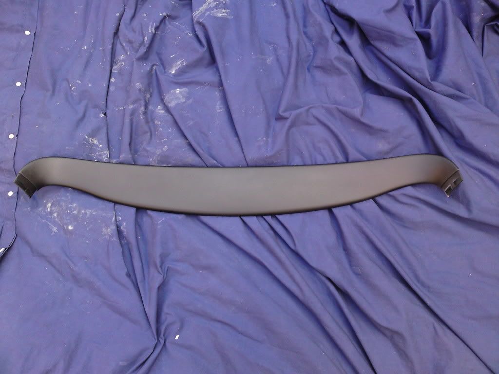

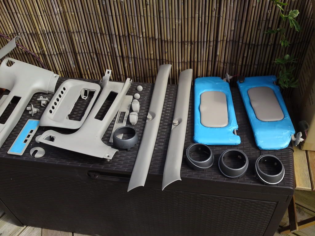

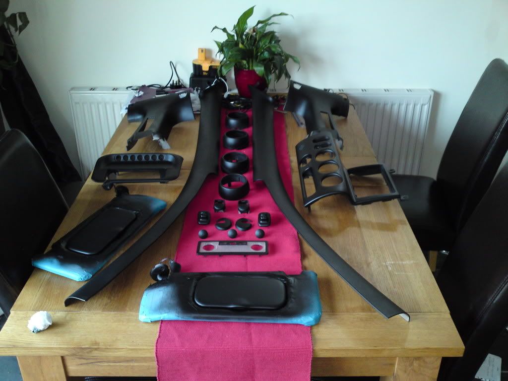

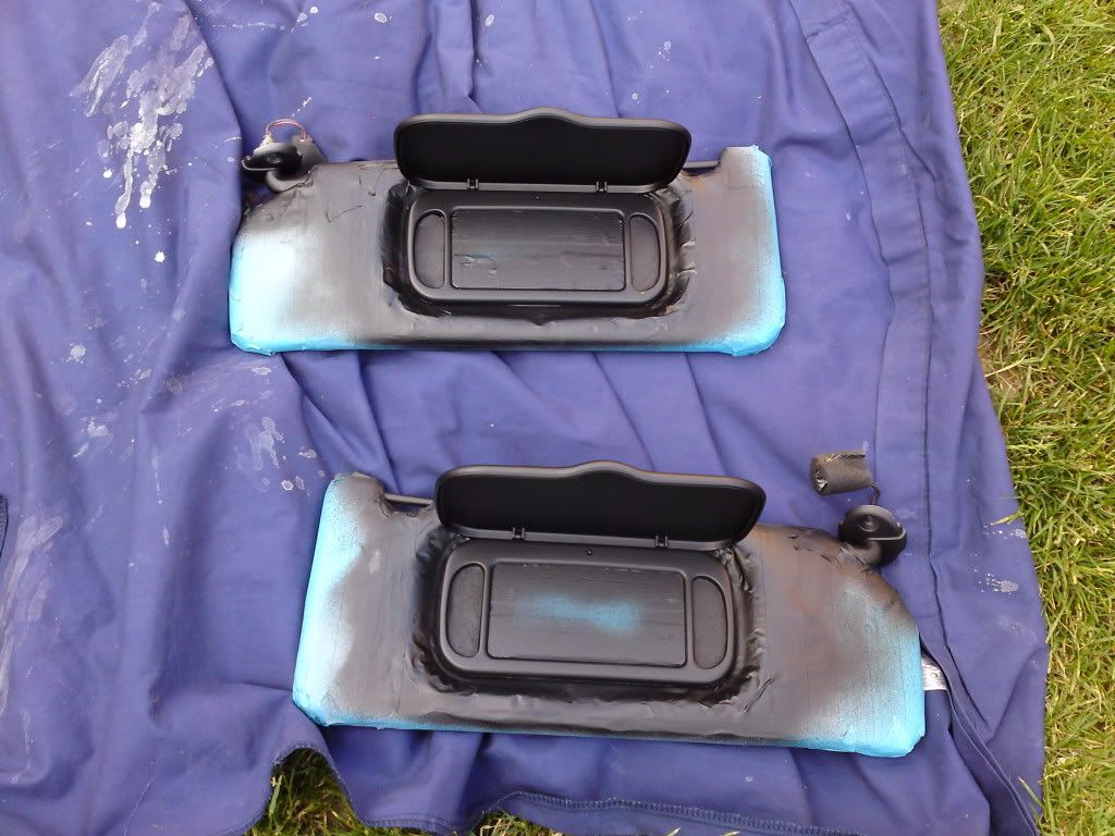

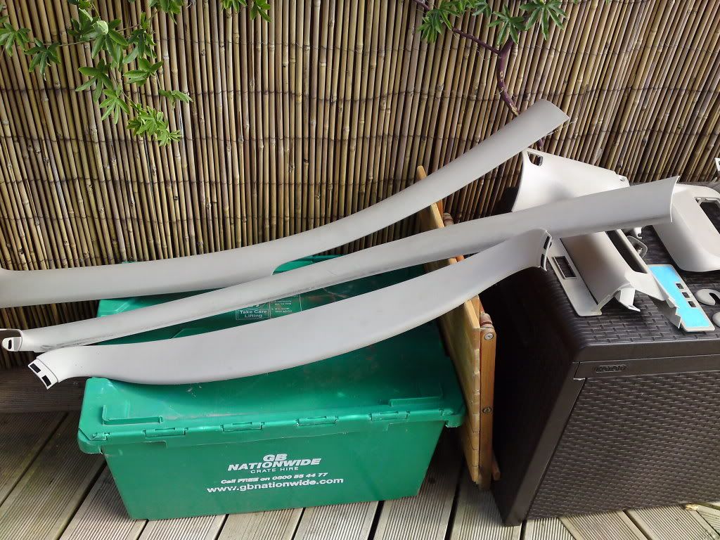

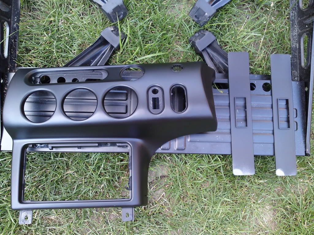

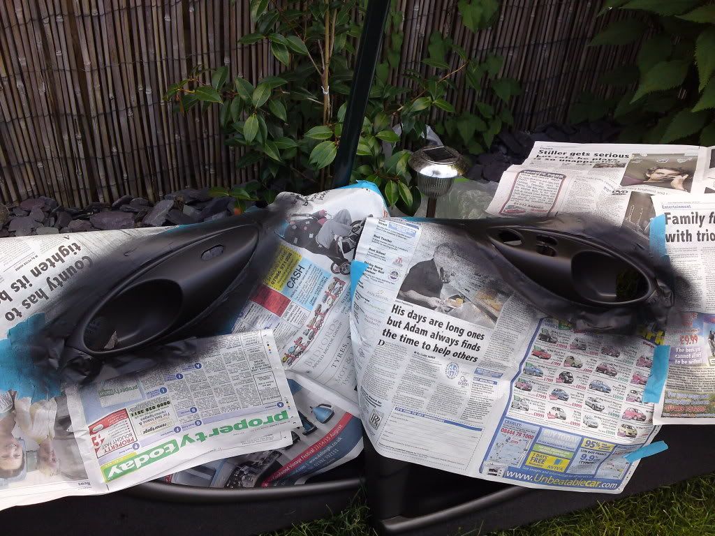

I then keyed all the plastics and gave them a good scrub with white spirit, before attacking them with black satin paint.
I even fitted the rear glass plastics. Let them dry in the car and free up some room on my kitchen table :lol:

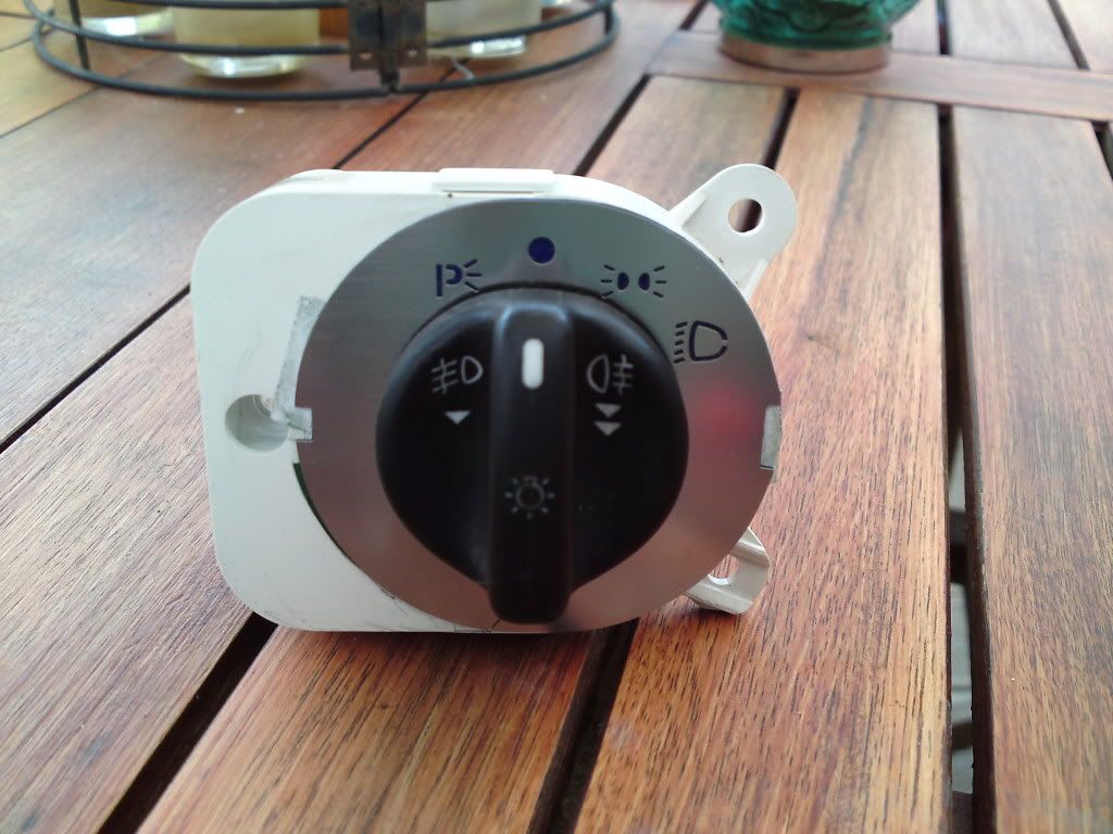

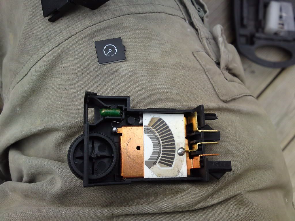

I then did the headlight switch cover...

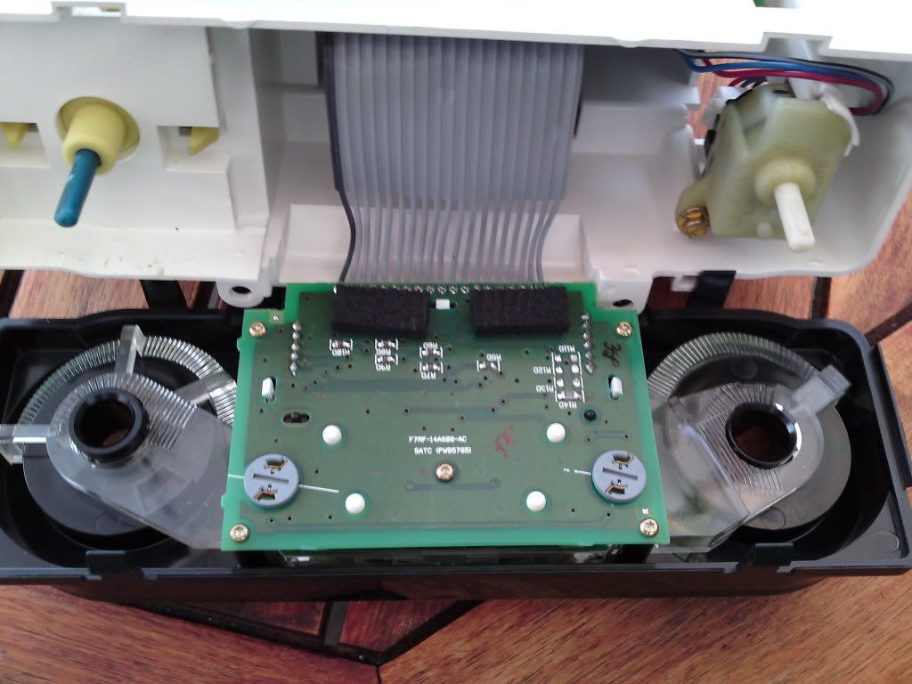

Started the HVAC unit but ran our of time as needed to settle down and watch something with my other half at 9pm...

Spent 3 hours sanding the headlight and have got up to 1200 grit. My hand and fingers were numb by this point so I moved onto something else...

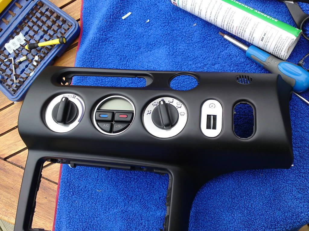

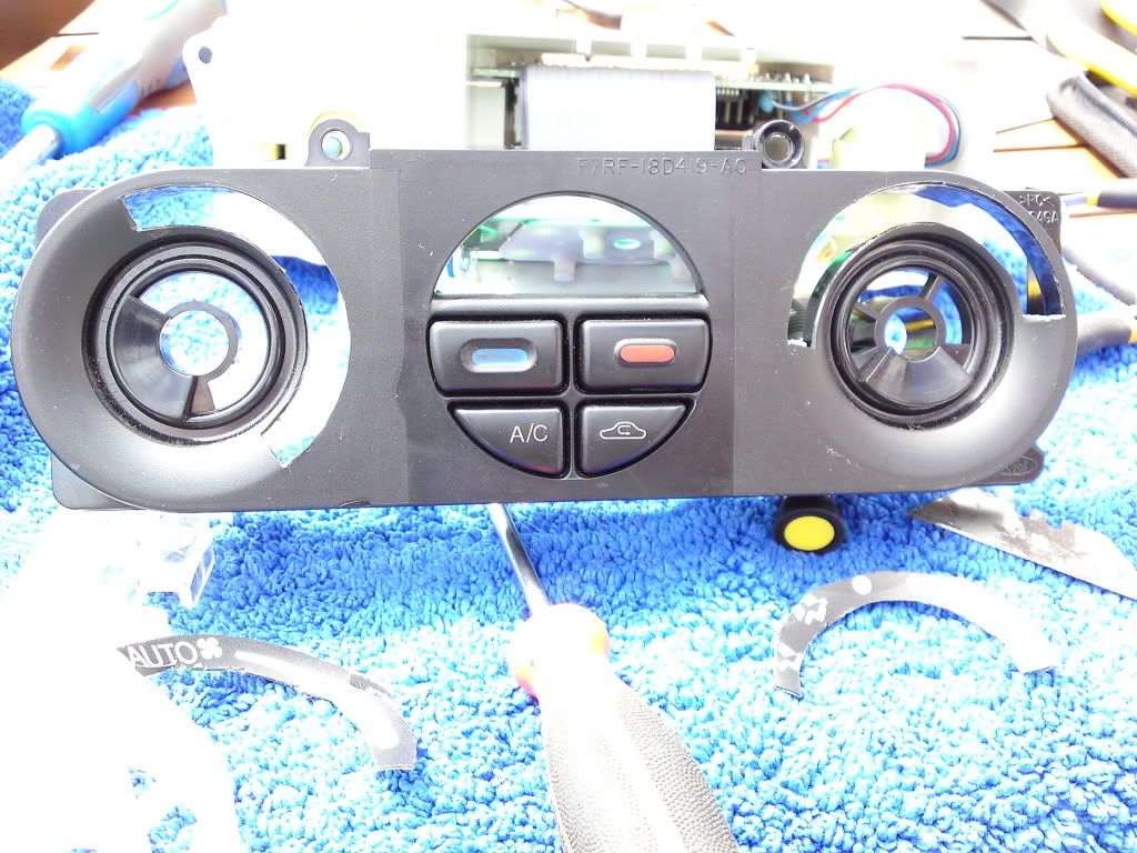

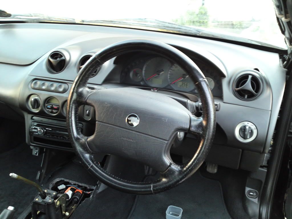

I fitted my HVAC kit. This isn't hard, but it does take time to do.
Also fitted the headlight switch surround. Think it all looks great against the satin black finish.
I then got the needles fitted and started to put the dash back together. Stereo not pushed fully in just yet.

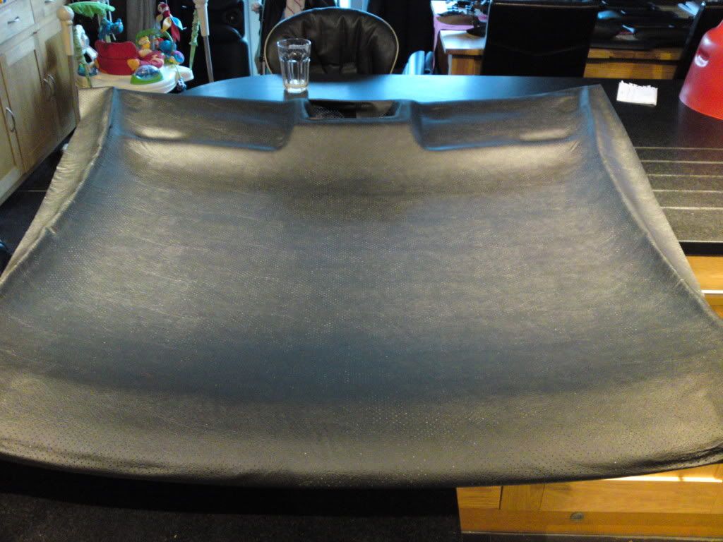

I then did the headliner. Don't worry about the white you can see through the dots. This is just the glue which when dry "should" dry clear.....ruddy well hope so anyway!!!
I also haven't yet wrapped it behind the sides and hot glued it. I prefer to wait till the fabric glue has fully cured before I do this, so don't worry about the floppy sides.

Looking spot on mate. Really enjoying watching this thread. Cannot wait to see the final product all finished

hi paul, my headlights are worse than them, bought some more from local scrap (£60 for the pair) yard which were a lot better but would love to get the originals back upto scatch unless anybody wants to make me an offer for them
