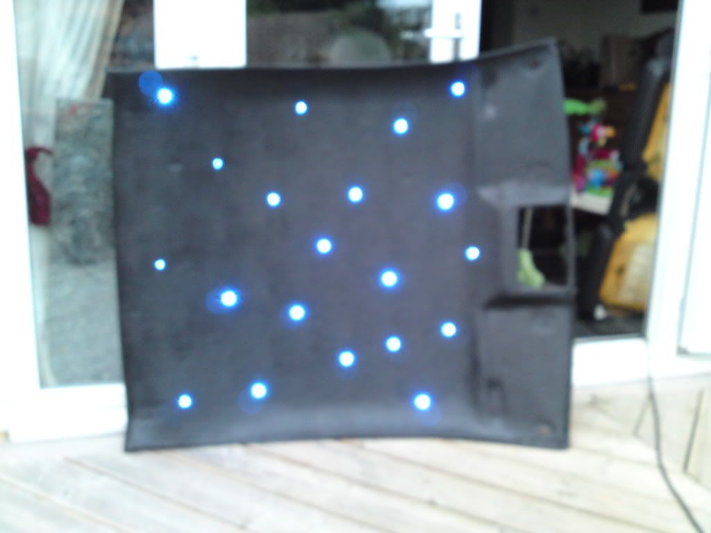

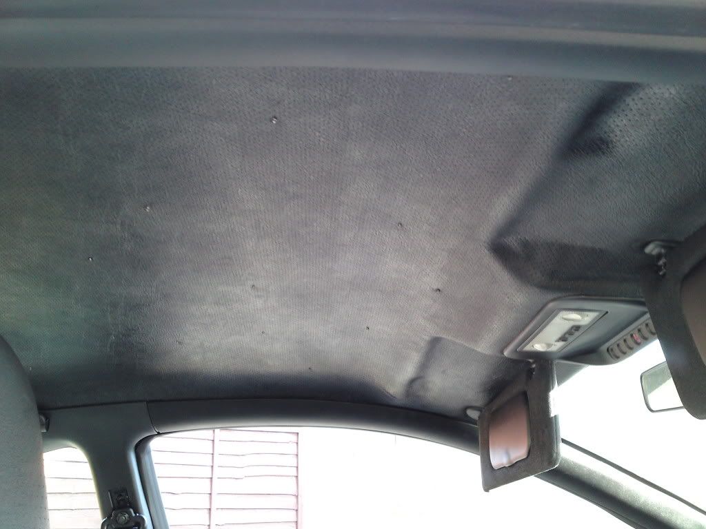

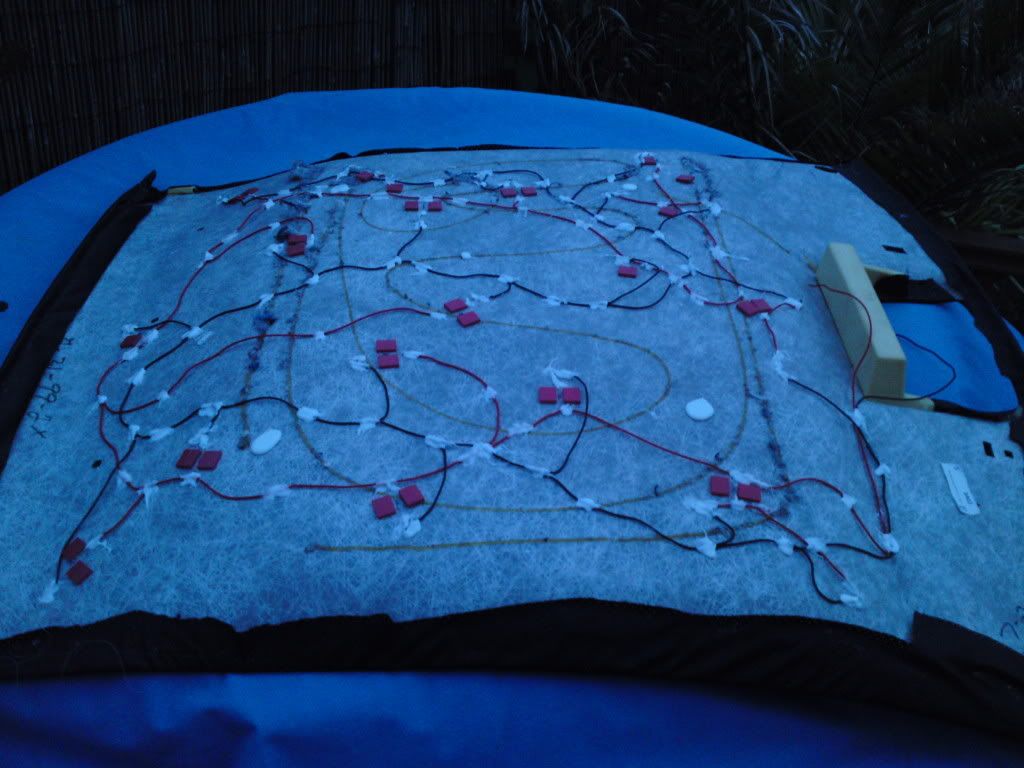

Alan wanted some LEDs in his headliner. Suggested a couple of strips running down each side but this just didn't look right. I therefore gave him a blue star ceiling !
Anyhow, over 10m of wires and don't ask how many joins I have had to solder. Each LED needs it's own resistor, plus live and negative feed. I also wired them up in such a fashion that if one blows, the others keep on working. All joins once tested were then covered in a blob of hot glue to make sure that with all the vibrations you get in a car, they shouldn't break free.
I started it at 3pm on Wednesday, and you can see from how dark it is when I finished and took the photo, that it took me many MANY hours !!
Sorry about the blurry picture.
The LEDs stand slightly more proud of the headliner than I would have liked, however, if I didn't have them poking through, the affect was a lot less dramatic.
They have been connected to the interior light so they come on when he open the doors and also means he can control them from the interior light switch.

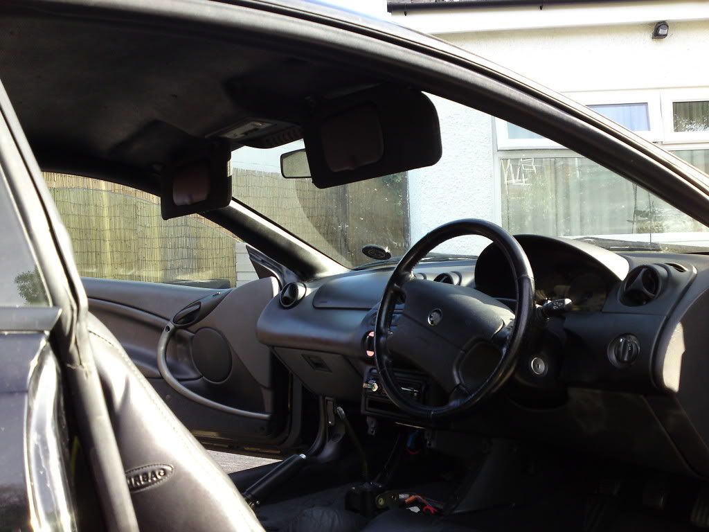

Sunvisors dyed black and installed...

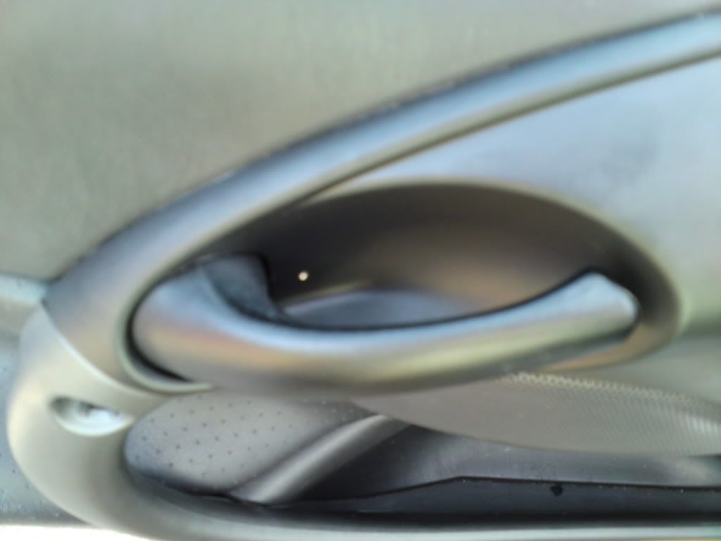

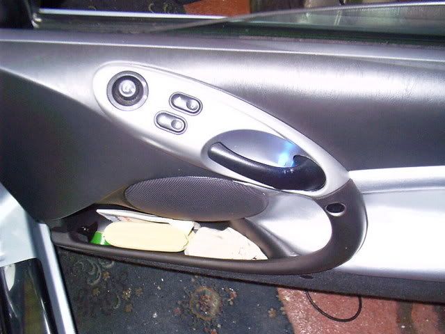

I also (because I am a glutton for punishment) decided to treat Alan to a small LED behind each interior door handle...
Again, apologies for the blury pic. I installed these with just the very tip showing so a) people wont catch their nails on them when using the handle, and b) so the handles are very softly lit at night. Didn't want them standing out like spotlights !

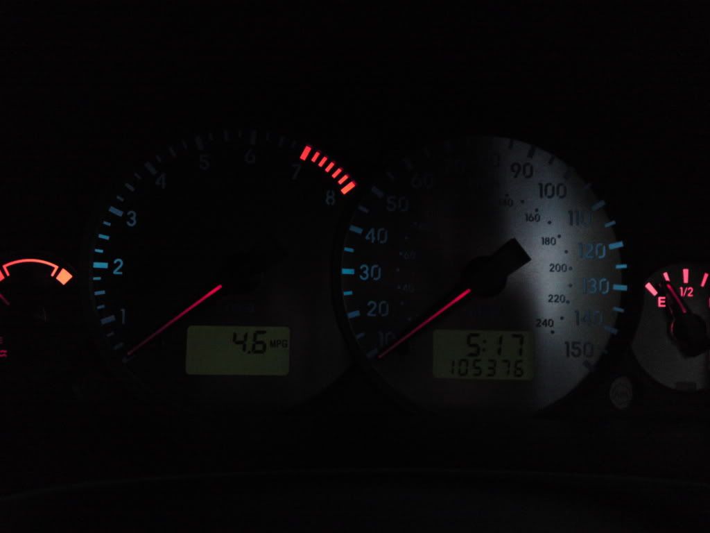

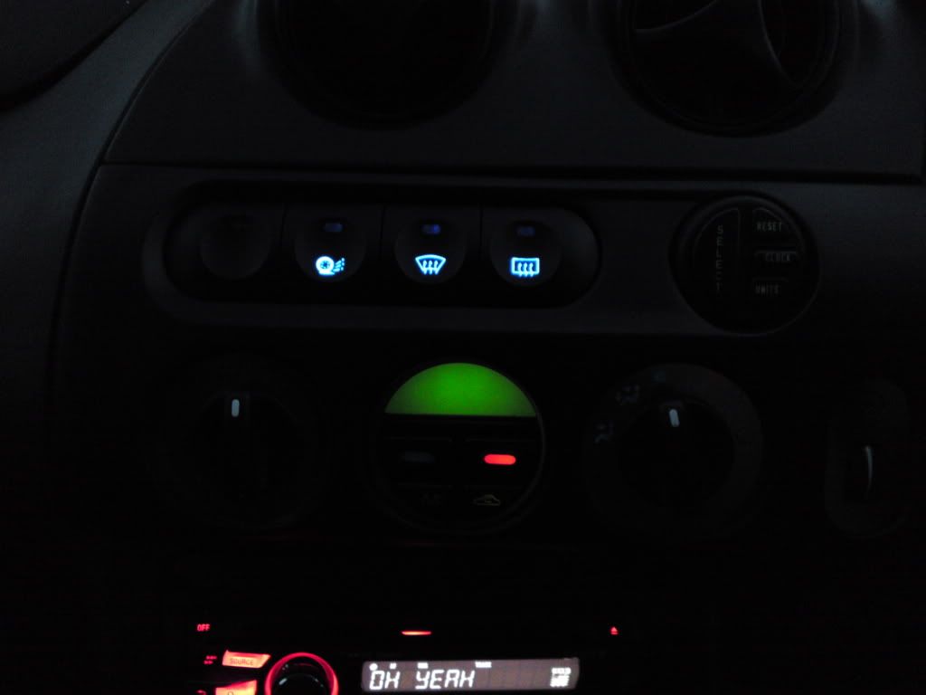

Blue switches installed (yes I know I haven't done the trip computer yet - I've run out of resistors) and as you can see, because Alan went for dark blue backing on his HVAC face plate, the light isn't shining through very well. This means I need to take the whole lot out and somehow rectify this.....without any resistors left, this could be fun...
Again, because of the dark blue backing, the speedo also doesn't light up well. 3 replacement hyper bright LED bulbs are on their way which should fix this problem....Complete pain as the clocks need to come back out but hey, nothing is ever simple for me.

HVAC lighting sorted (1 hour)

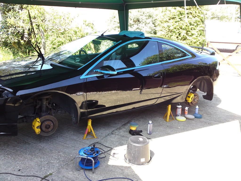

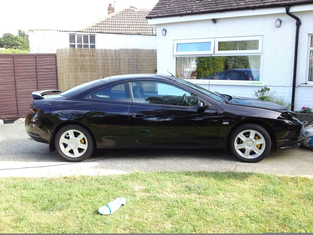

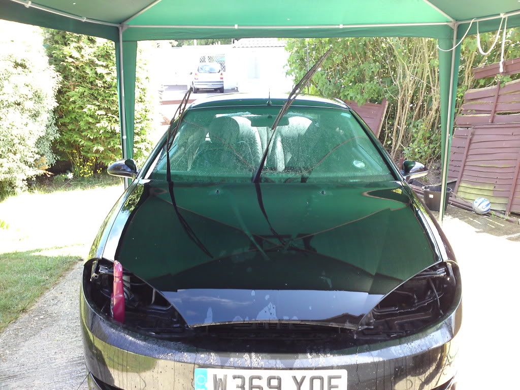

Jet washed the whole car and then gave it a good double wash with special cleaning shampoo that prepares the bodywork for polishing etc.
Time for one of these....

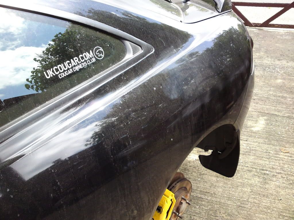

I was very suprised at how little dirt the clay bar picked up TBH. Only thing that was worrying was the fact that no matter how much lube I used on the rear bumper, because of the AWEFULL orange peel, it just kep on wanting to stick to it :cautious:
Car was then jet washed again. Followed by another going over with the shampoo. Followed by yet another jet wash rinse.

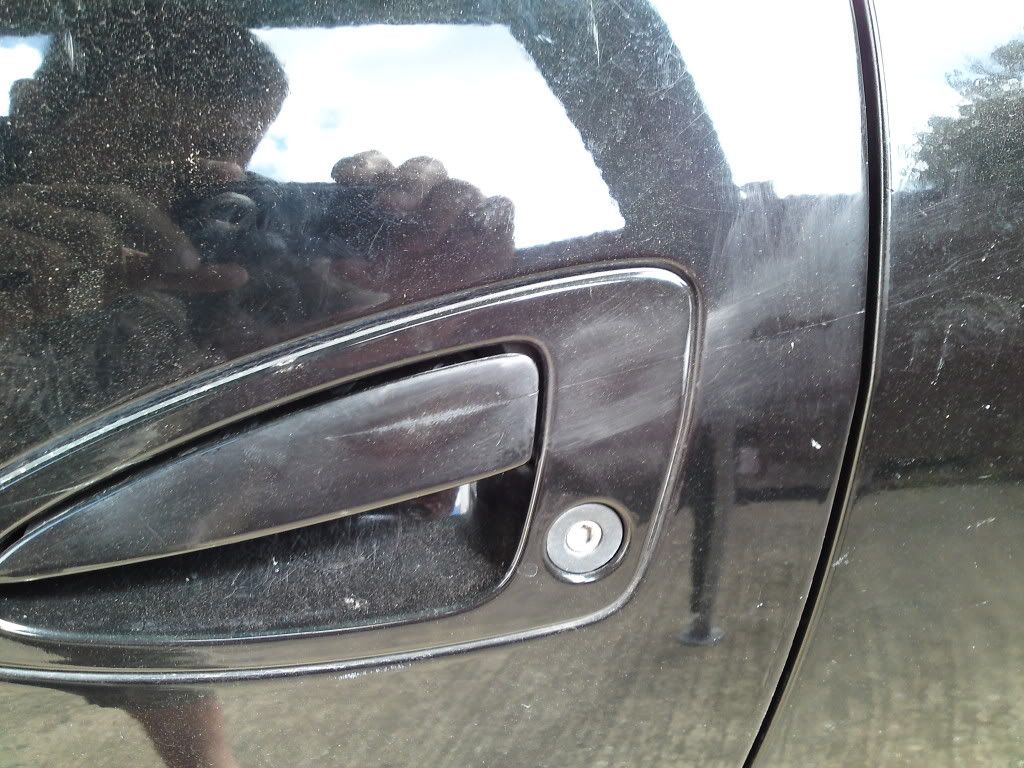

First things first, when Alan warned me his paintwork was in bad shape, he wasn't kidding. His car has had so many resprays here, there and everywhere and all of them have been done badly !! The amount of overspray and orange peel in places has to be seen to be believed ! (n)
He also has a number of weird paint defects. The worst of which are through to the primer :cautious:
Look at the difference in shine between the right and left side

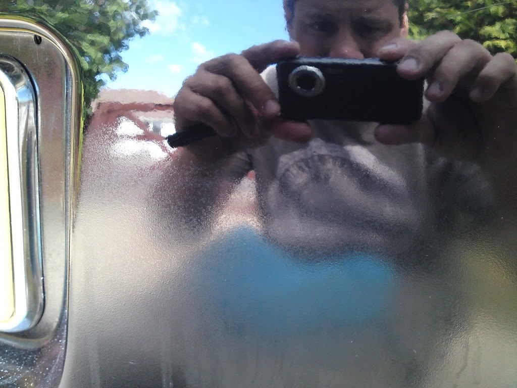

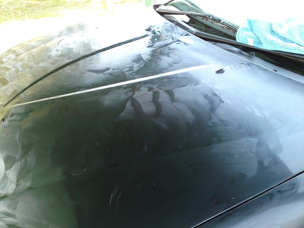

This photo shows the differance after just 1 pass...

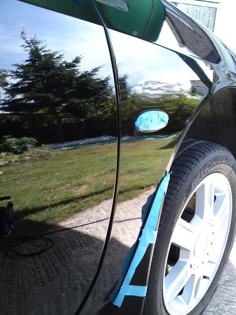

Now because I had soooo much to do, I didn't have time to take lots of 50/50 shots ;like the above so just some straight forward photos...

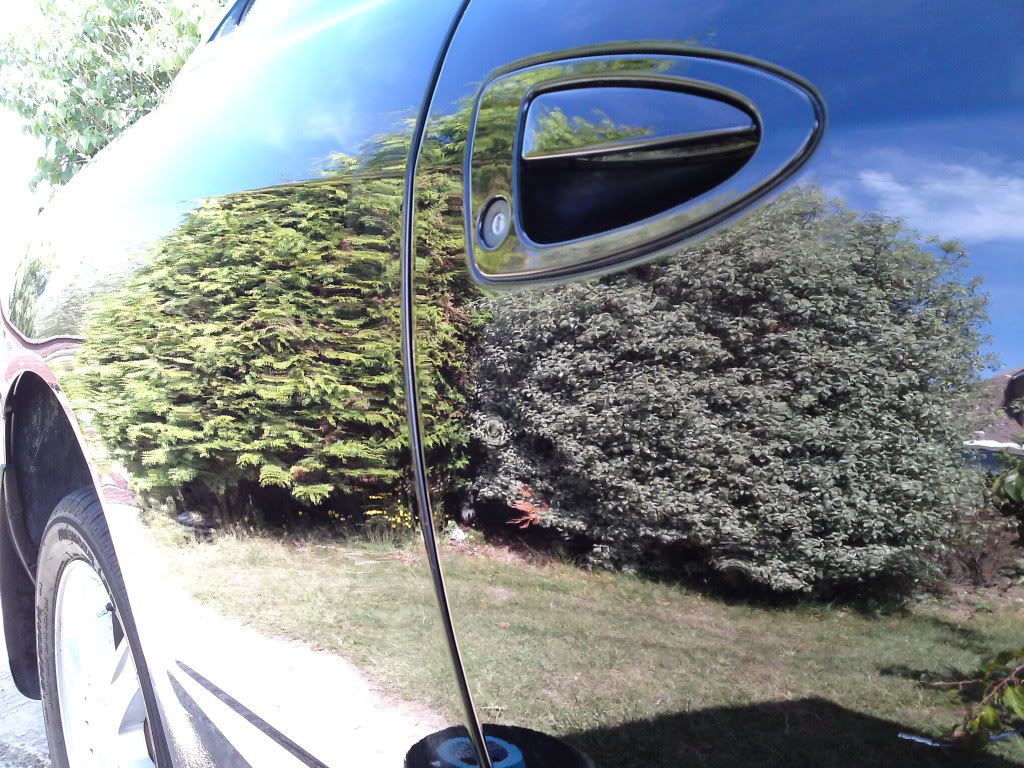

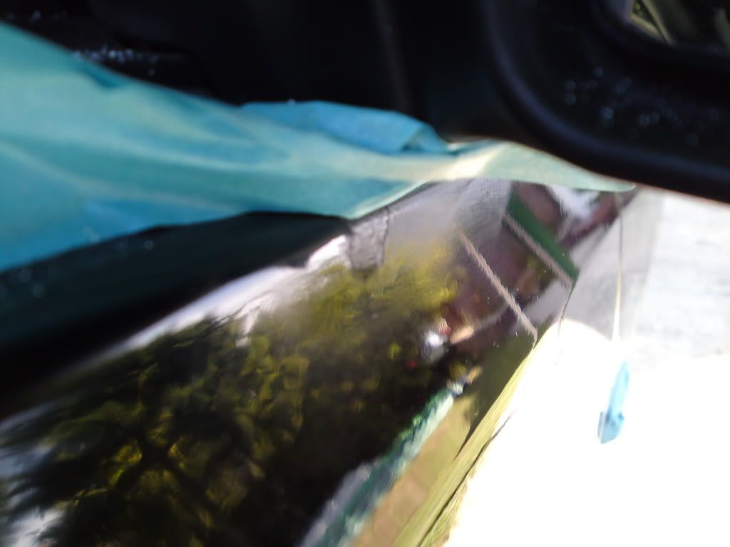

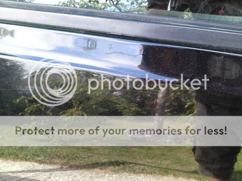

This was the passenger side door before being polished with Black Hole glaze and DoDo Juice wax.....oh...and before people think I am swearing and report me...the reason for raising my middle finger can be seen in the photo below it :angel:

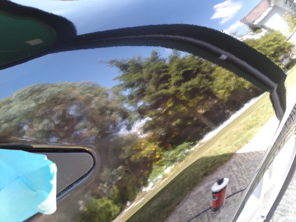

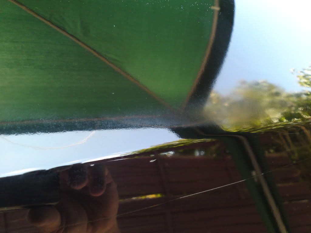

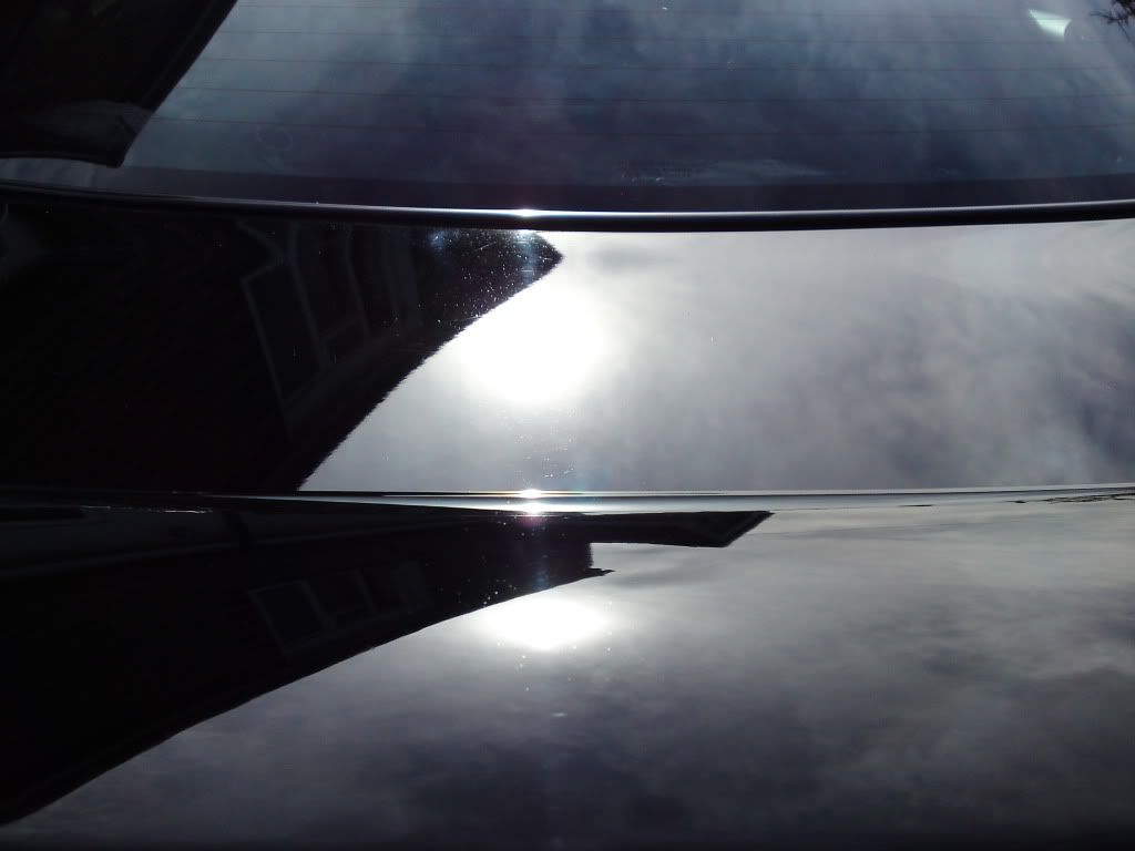

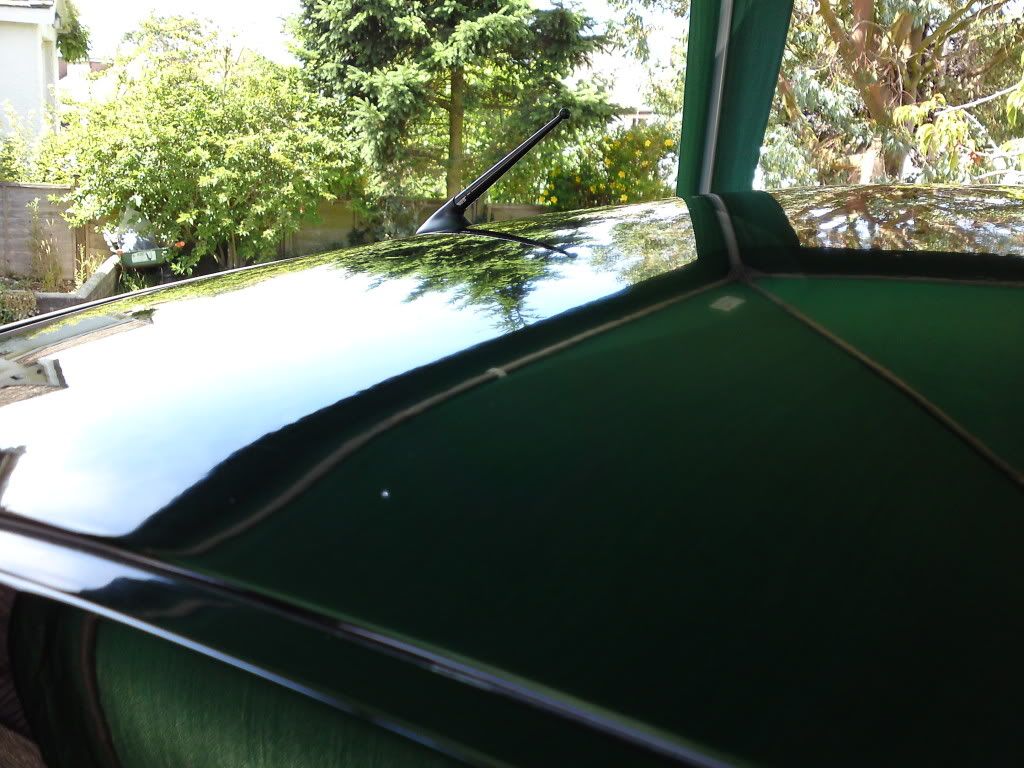

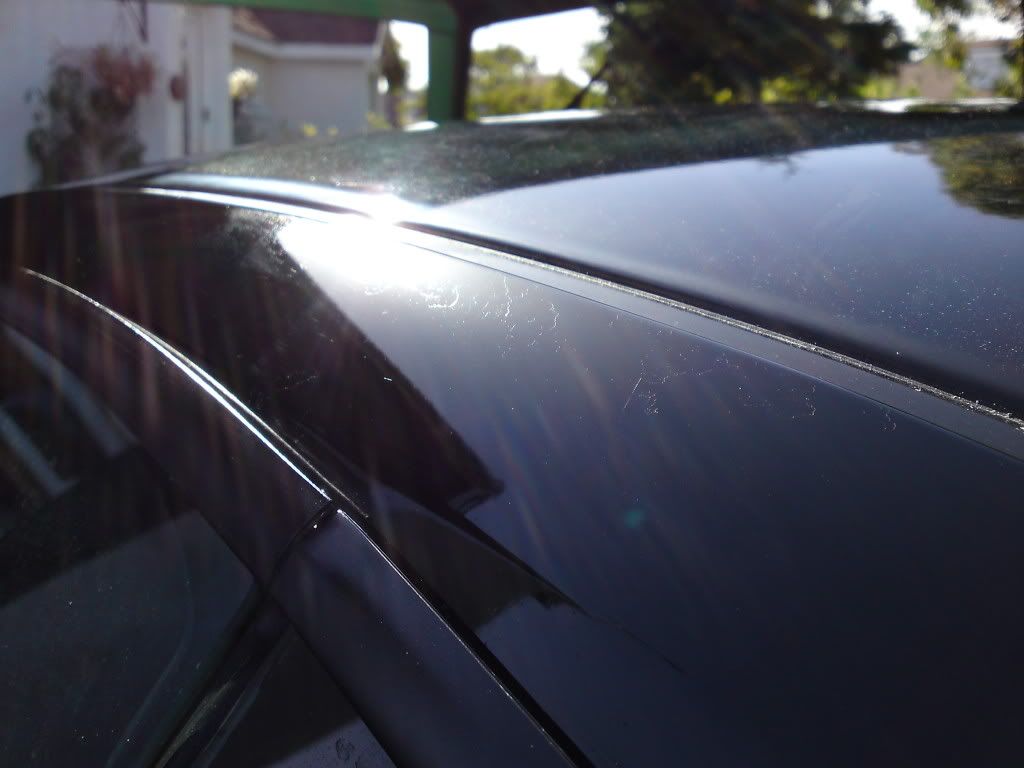

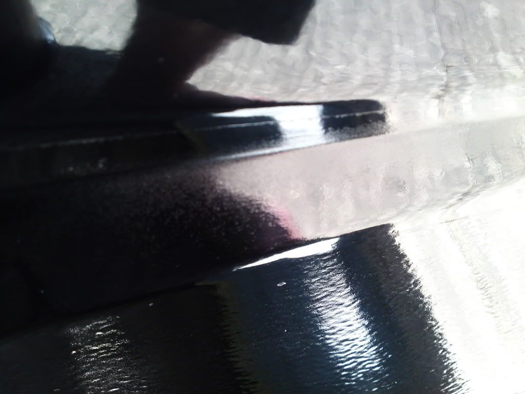

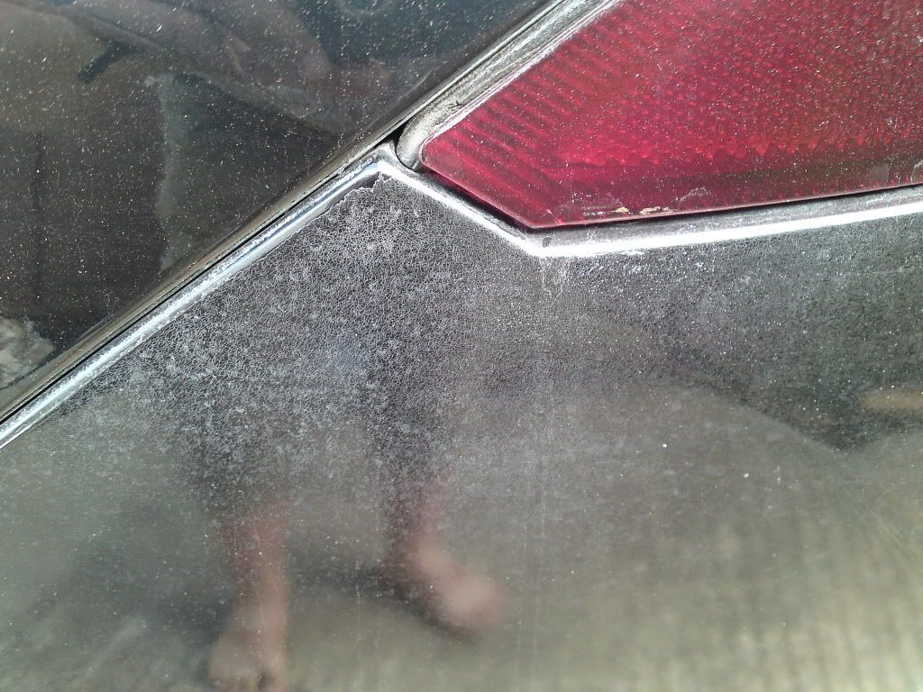

You can still see the rippled effect of the paint on the rear quarter panel even after all my cutting and polishing!! :cautious:
Now look VERy closely at this picture and you will see a wavy line going down the middle. This looks like old lacquer and new lacquer. The new stuff going ever so slightly milky compared to the OE stuff....
You can also see it again on this photo. No amount of cutting can remove this as it is the actual lacquer that has "turned".
Anyhow, I battled on and was still very happy with the overal results...

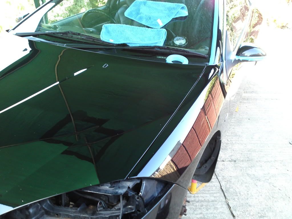

This is the bonnet before wax...

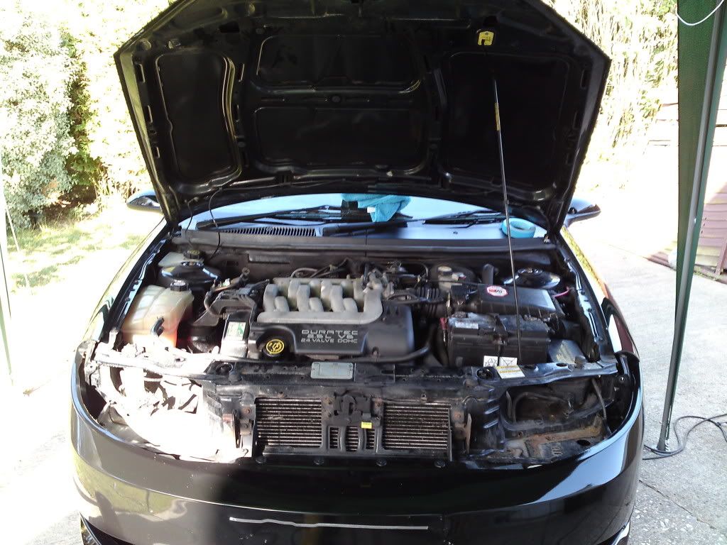

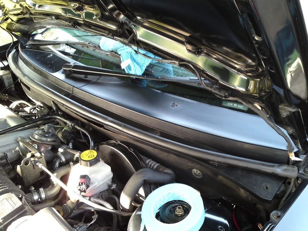

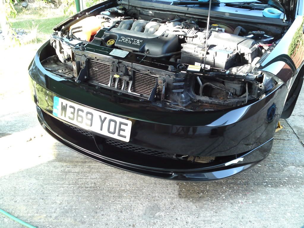

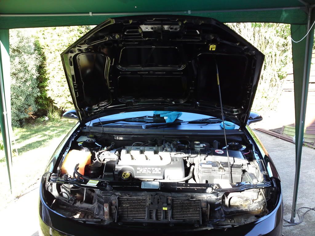

Engine bay given a quick going over.
Before...
After...(bad lighting)

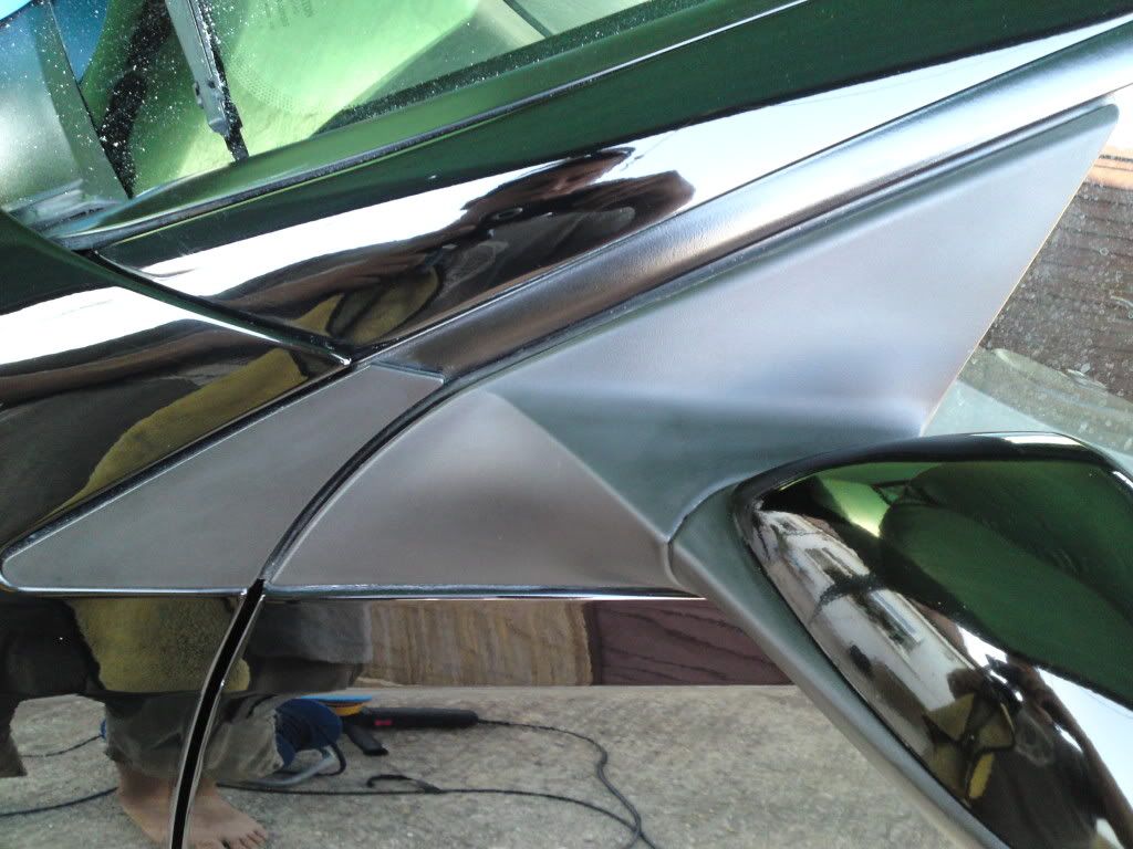

Extrior plastics...
Can anyone say DULL !!!!

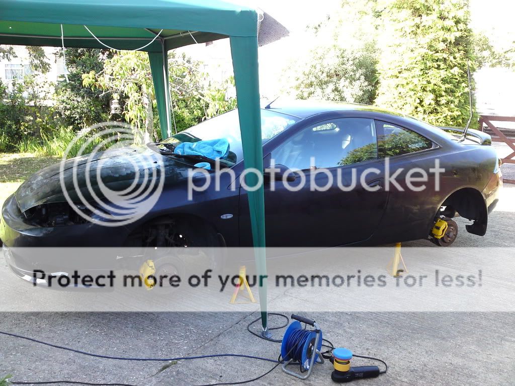

Right, well today was another very busy day. So busy I am currently watching the GP I recorded as I didn't have time to stop and watch it.

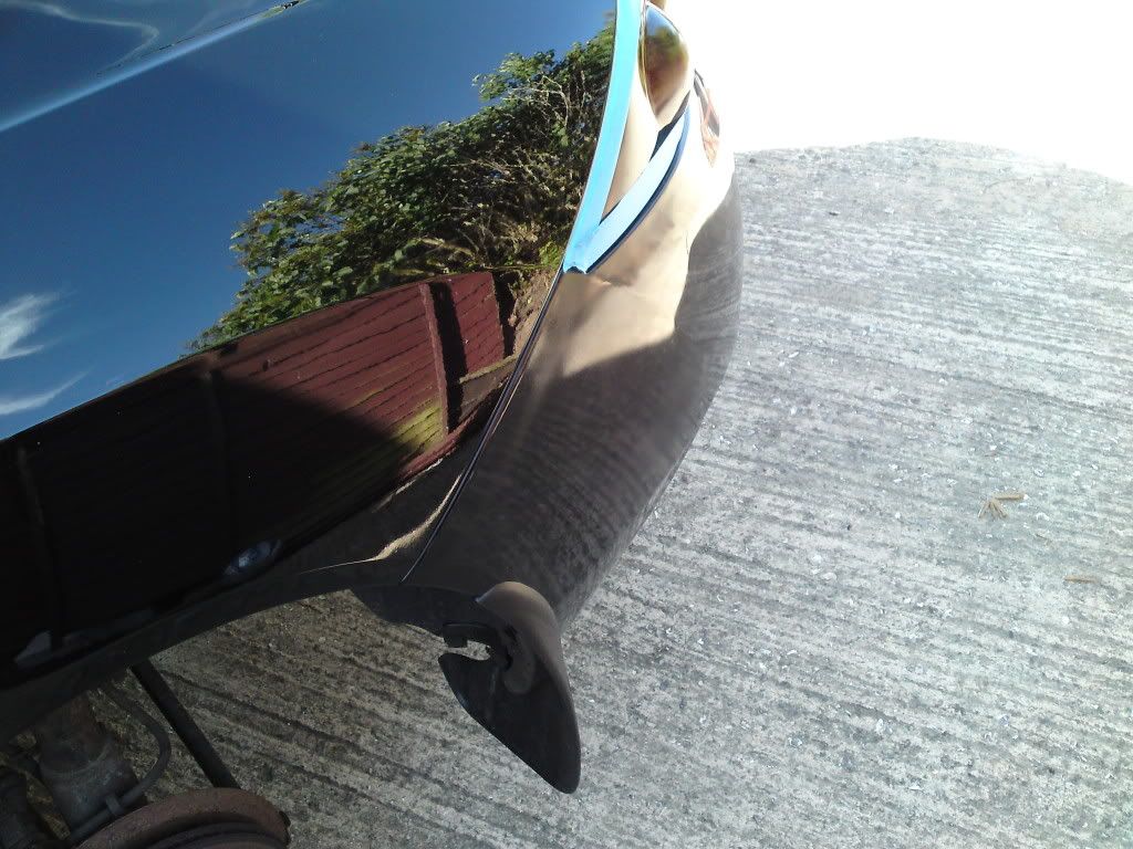

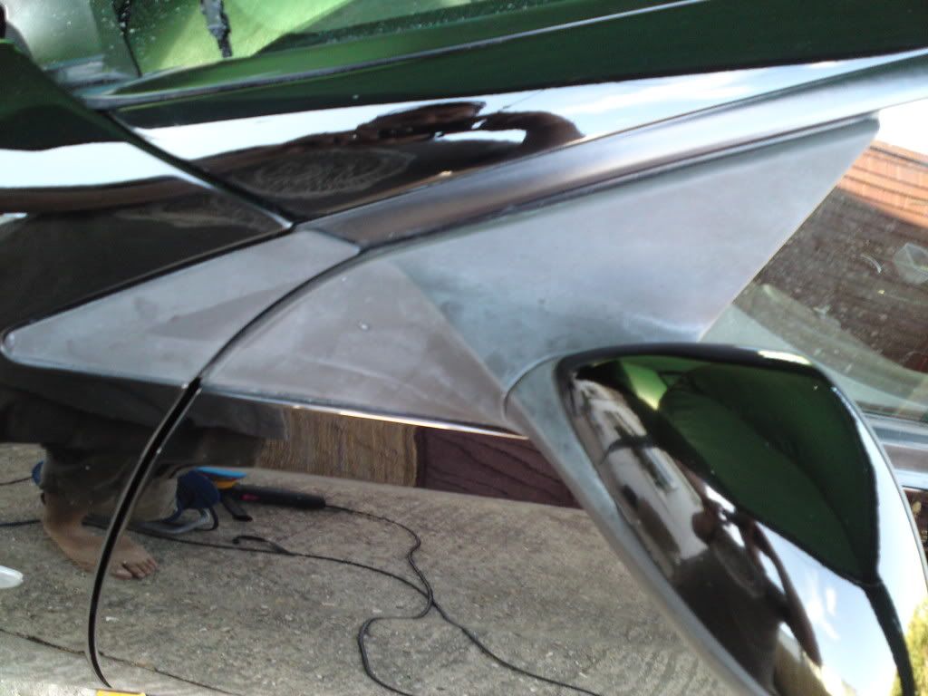

More cutting and polishing but also lots more paint defects found.
Take a look at these photos to see the difference between the front wing and the door...Both have been cut and polished the same!
More orange peel...
Some damage under the drivers side mirror...

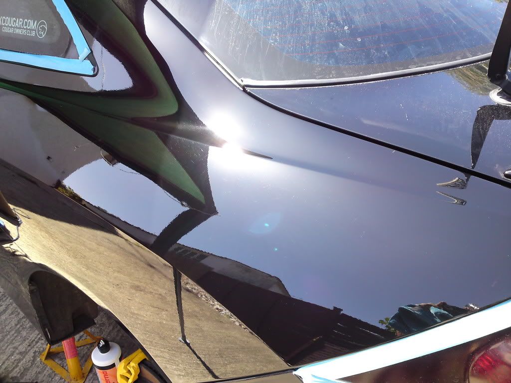

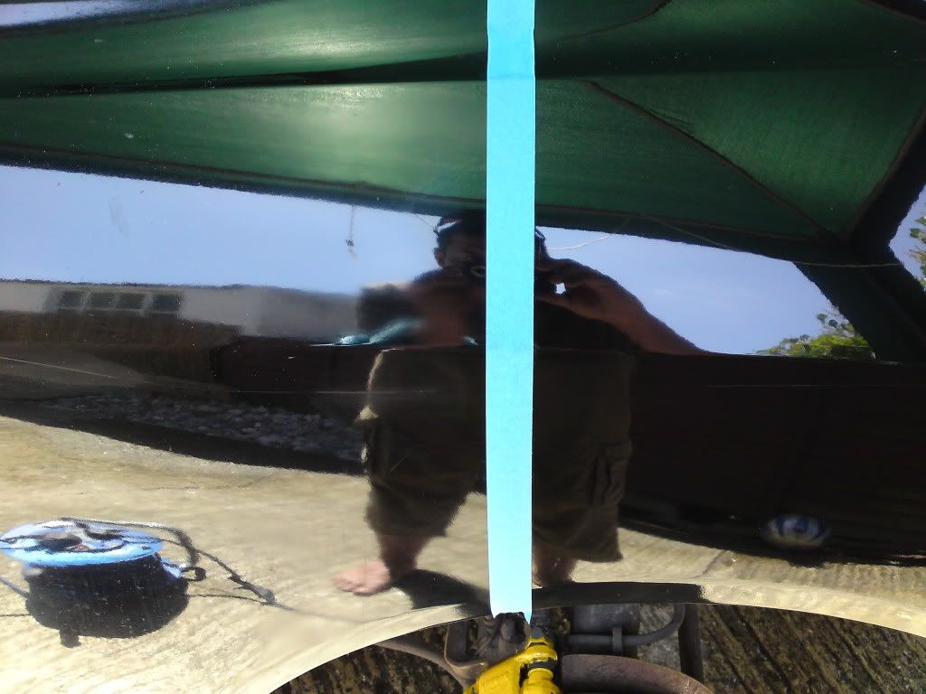

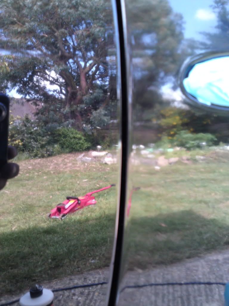

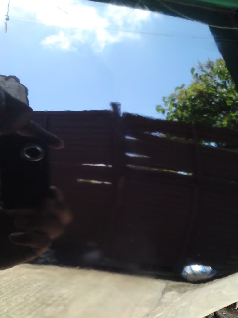

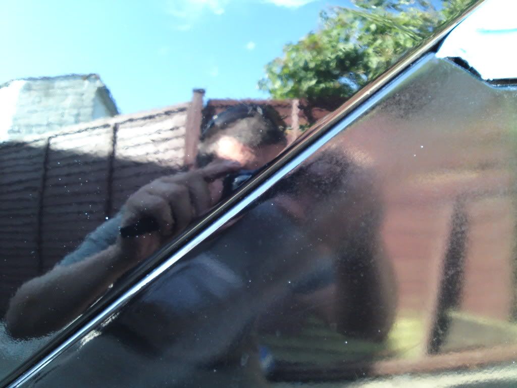

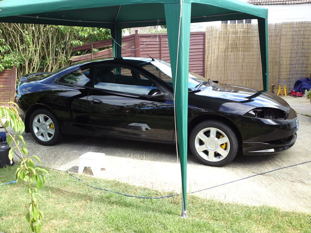

Anyhow....time for some relection shots to cheer Alan up before he kills himself (or me)...

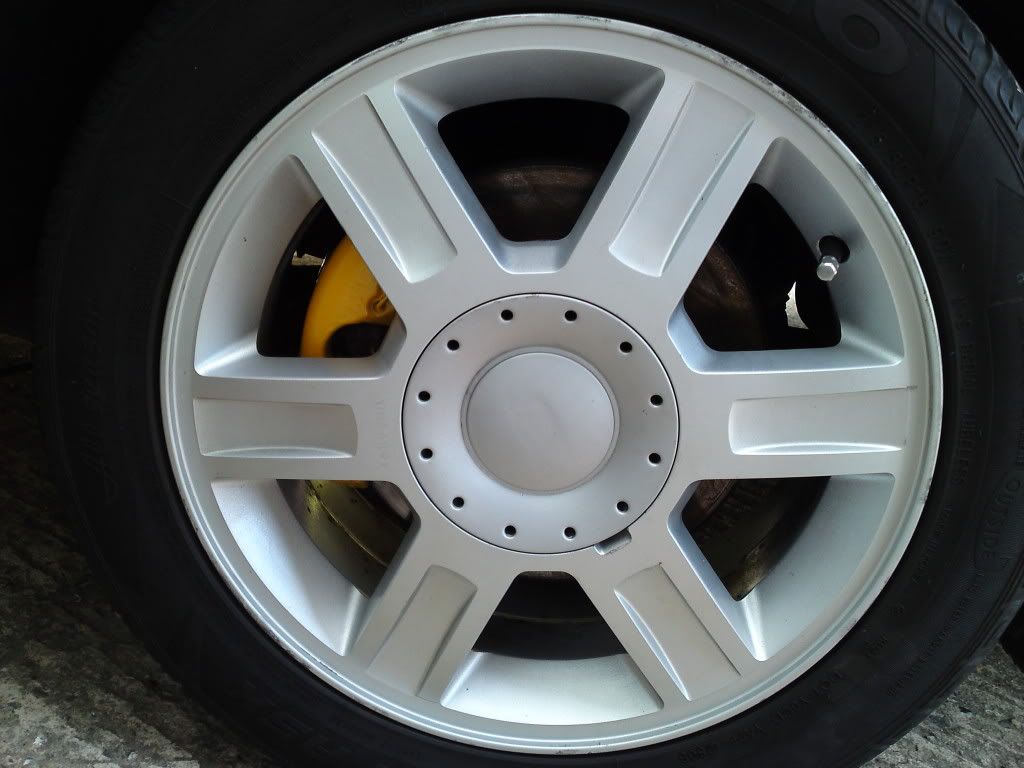

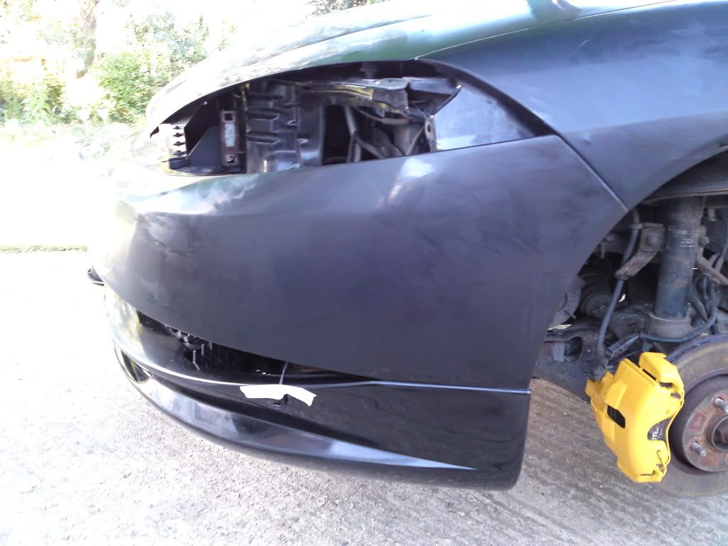

Wheels were put back on. Still not 100% happy with the finish of the calipers, but just not enought hours in the day...
Oh, and BTW, the wheels were only given a quick once over as Alan has some nice new shiny rims to go on the car soon , so no point wasting time, money and products on these.

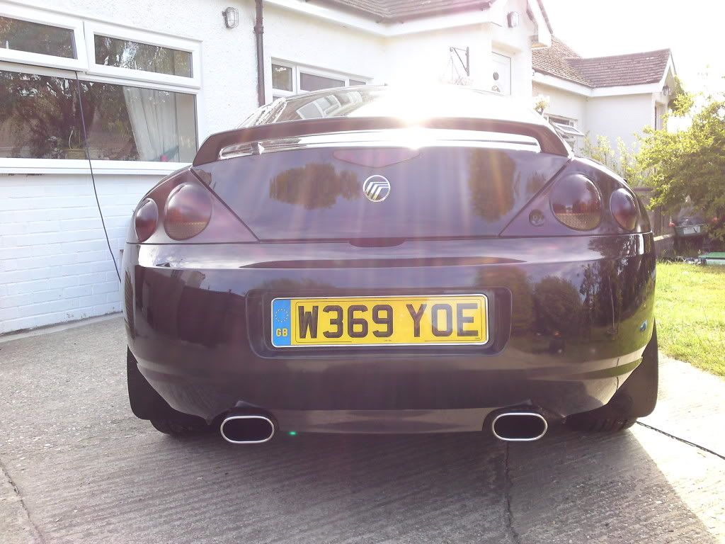

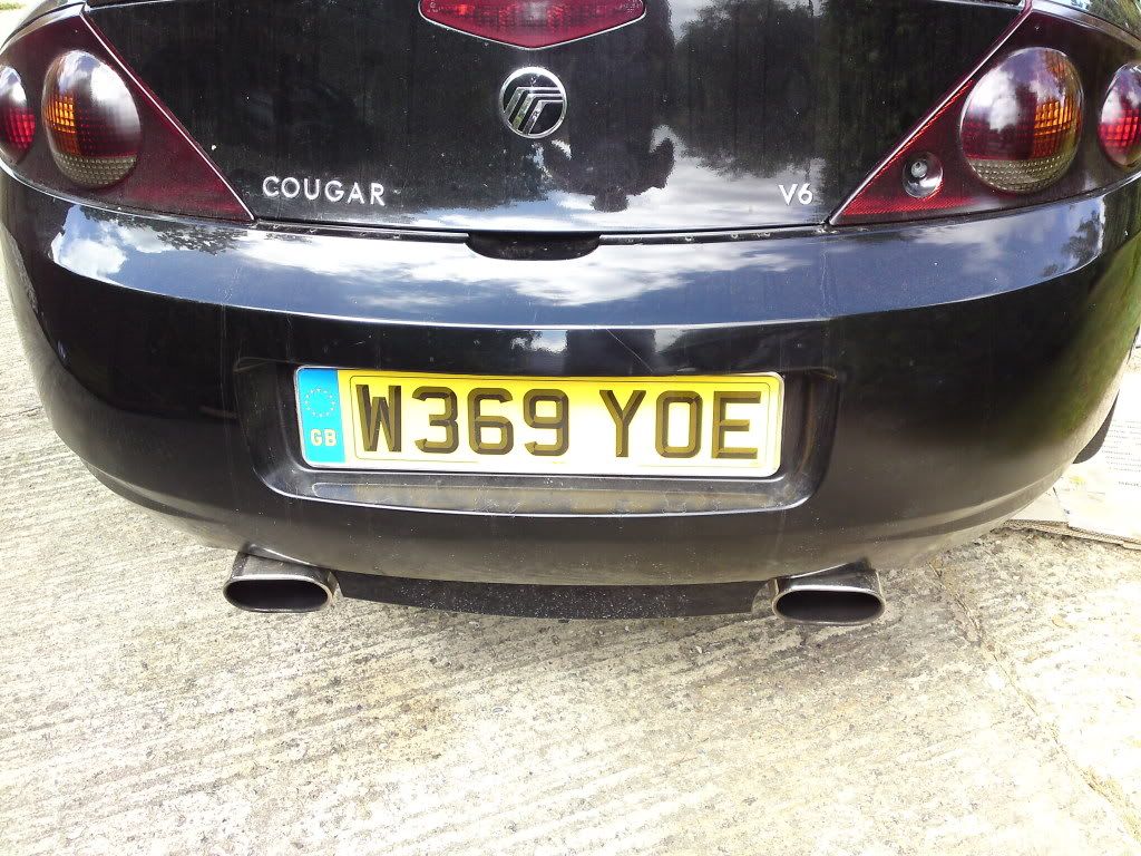

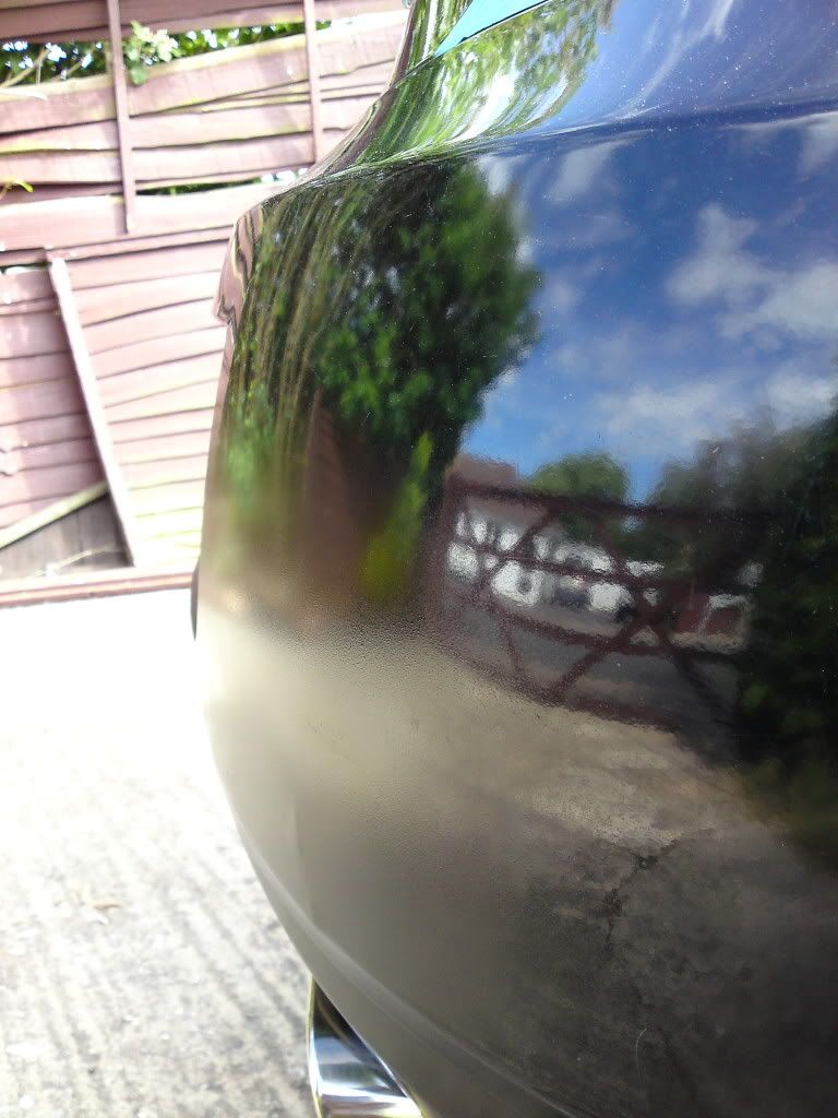

I then moved onto the rear bumper (shudder). Look at these photos...
Now clearly cutting compound was never going to be enough to remove this horrible finish.....so out with the wet and dry......gulp.
After a couple of mins and a heavy polish, I got this result...
Fantastic I thought, only at least 60% of the rear bumpoer left to do......I carried on but just as I thought, whoever the numpty was that sprayed the rear bumper didn't do ANY prep. They must have scuffed the bumper and then with no rubbing down, no primer and no lacquer, they simply rattle canned over the top. The scuff, was ever so slightly begining to come through this **** repair !!
I therefore had to leave well alone. The whole rear bumper needs rubbing down and spraying properly I'm afraid.

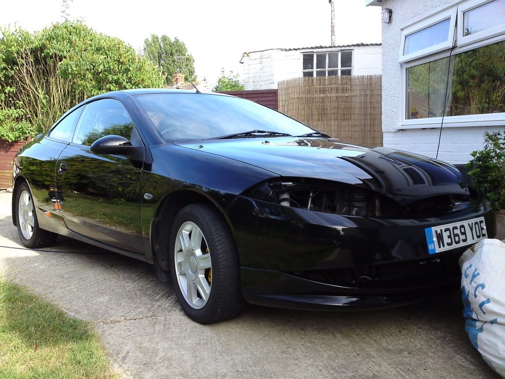

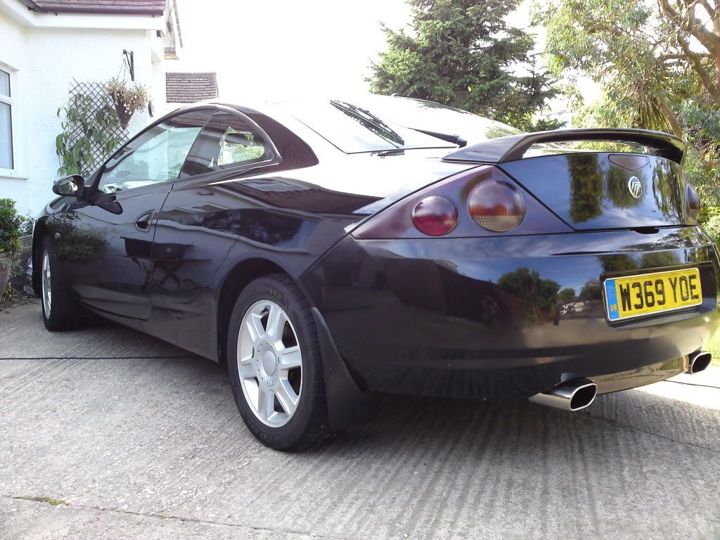

Anyhow, she is still looking good !

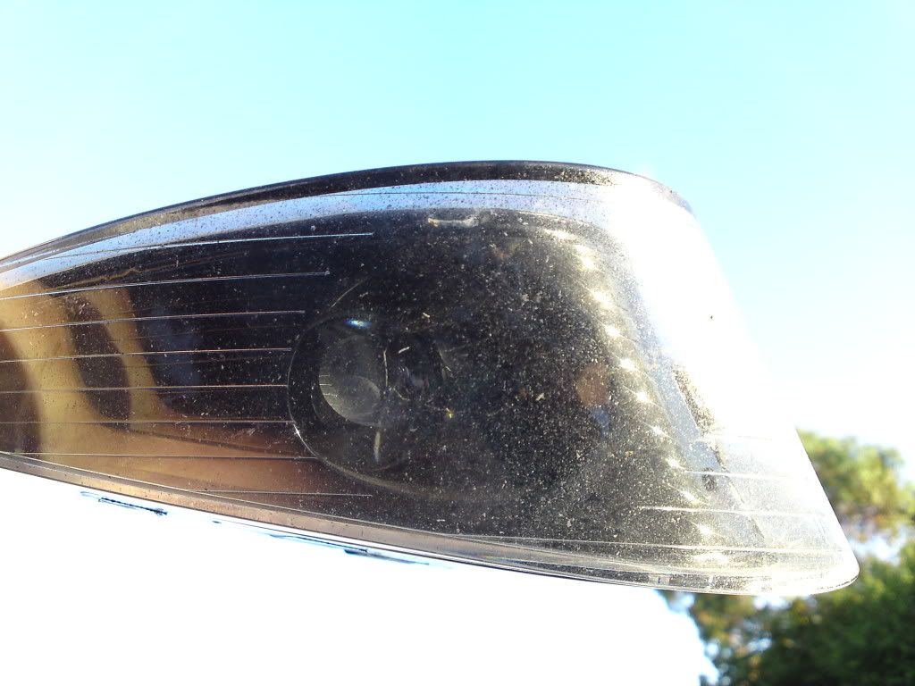

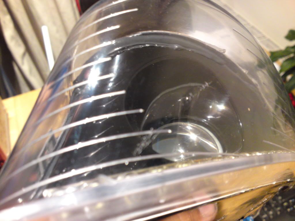

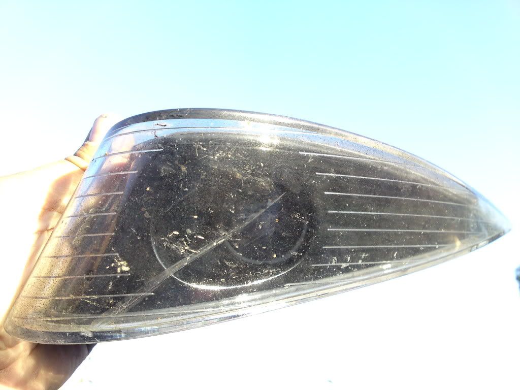

Right.....................remember those crappy foglights??
Well after yet MORE sanding and polishing.....
The scratch has actualy caused lots of tiny stress cracks right through the plastic which wont polish out...but still a million times better than before.
No idea why I didn't take a piccie of the other fog light. Doh!!

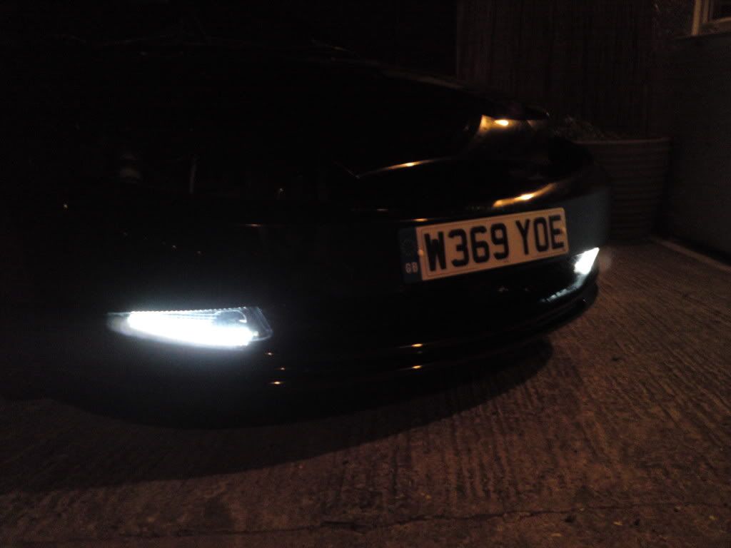

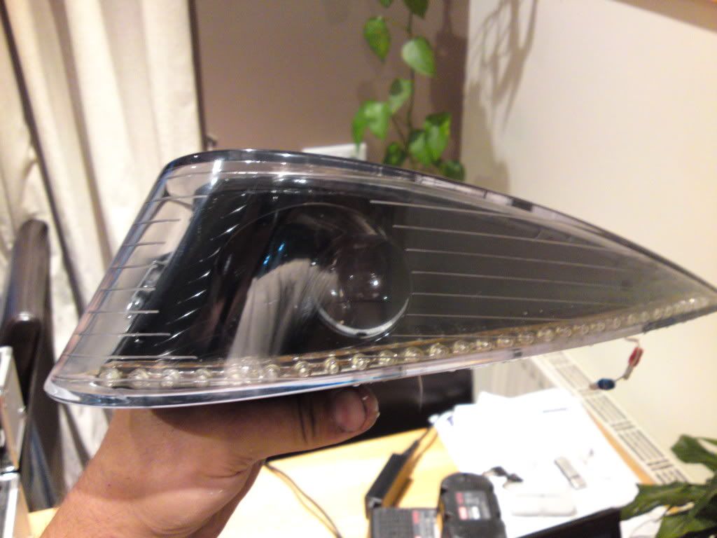

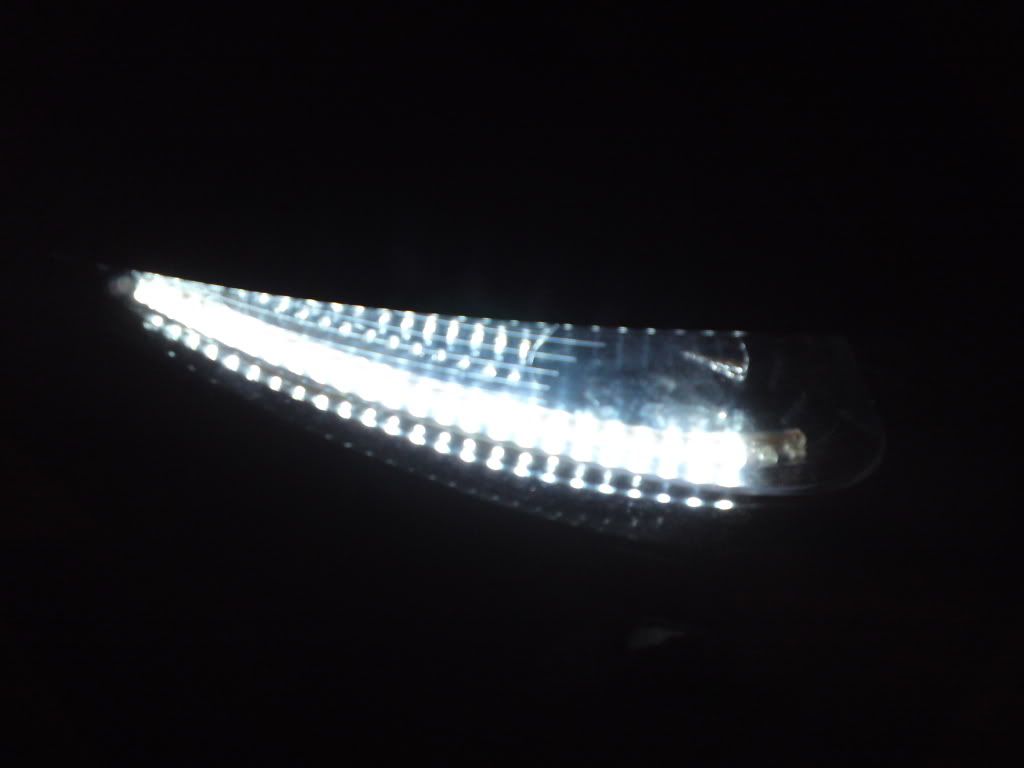

Fog complete with running lights installed...
Gutted that both LED strips...the last 2 LEDs don't work !!
To be fair however, you have to get up very close and look hard to notice. When driving, nobody is going to notice/spot it. Shame none the less.

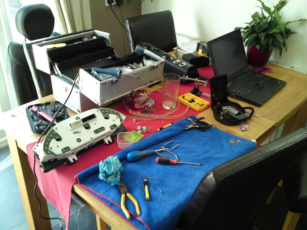

While working at the kitchen table..

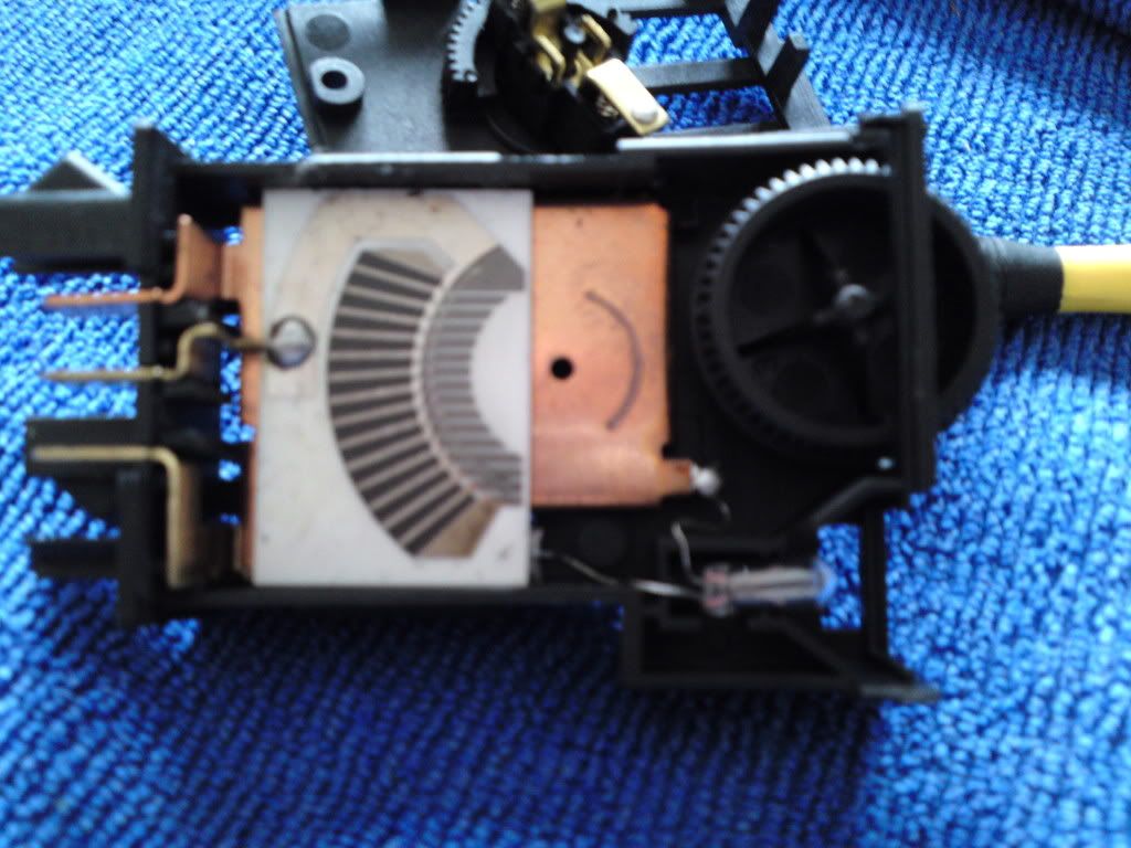

I also fixed the problem with dash brightness switch not lighting up...and also cracked it open to fit a new blue LED (not fitted in the photo..
The gutting thing is, his headlight height adjustment switch doesn't light up ! Very odd, so I removed my centre console and gave him my switch.......but that still didn't work in his car. Tried it back in mine and it works fine...tried it again in Alans and nothing. I don't have the time to investigate this annoying gremlin.

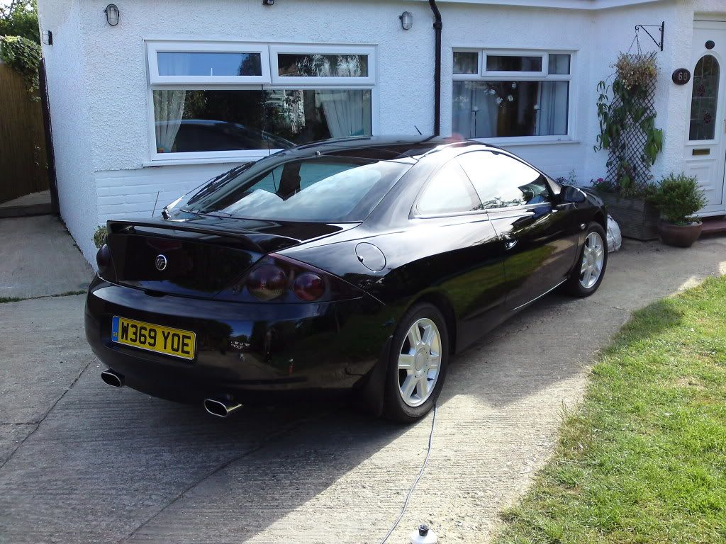

Car should then look great. (y)
