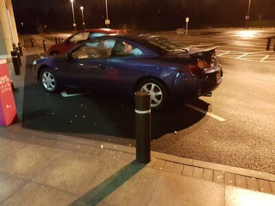

I've retrieved all my ST200 bits and pieces from the loft and I reckon I'm going to give it all a go this weekend. I've not made any changes to the Cougar in months!
