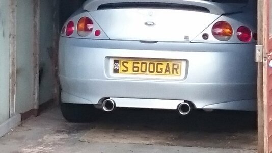

Lets see who can tell whats happened :)
Someone has nicked your aerial
