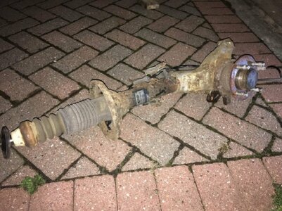

Result! Rear hub now removed (thanks Matt) with the two uppermost bolts coming out relatively easy. Ended up removing the ABS sensor by unplugging the connector under the rear seat, helped but the fact my interior isn't really in, and I'll worry about getting it out at a later date. I even managed to remove the carrier Torx bolts without rounding them off, so clearly I'm now officially some kind of engineering demi-god! A couple of gratuitous pictures;
Now I know nothing about how these work, but should I be able to push the top of the shock down, fairly easily? It does slowly return, but I assumed they'd be really quite stiff? I could post a vid tomorrow if I'm not describing this well.

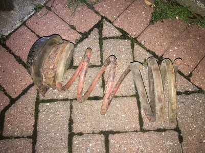

Next was the spring. I was thinking I may need to send this into work and get it x-rayed for fatigue or fractures, what do you chaps think? Worth doing?
I assume the fact the bottom half dangles when I hold it up is a bad thing right?! In all seriousness do I now need to remove the 'top' of the mount somehow I haven't had a look as I had to pack my stuff up, but I figure it just needs removing somehow.
Again, thanks for the help getting me this far, hopefully the weekend will have me remove the other side, the arms and sub frame. (y)
As the rears aren't under so much pressure as the fronts, yes you can quite easily press them down maybe a couple of inches. You'll notice just how slack the spring is in its seat, that's normal whereas the fronts are very tight and always need spring compressors.
The top mount looks passed its best as well. While it’s all stripped down might be a good idea to replace the lot both sides mate!

I had always intended to refurb and replace mine as they're knacked and an advisory, but if they're looking borked I'll just have to get replacements. They are after market (Eibachs) so not original. Might need to replace the springs though, not sure that one's going to get to see any future action.

If the top plate is solid it won't need replacing. It'd be an idea to give it a good clean up though and a thick coat of paint before it goes back. Tbh, what i can see of the gaitor looks ok to me so no need to replace that unless it's torn etc. Are you renewing everything due to the broken spring Sam? If the shocks are good and you're changing all back to standard, i am looking for spare eibach parts ;)
Yeah that spring only has one place left to go...the bin :LOL:
Shock sounds okay Sam, you should be able to push it down by hand and it will slowly creep back up
The top mount is the piece where the two 10mm bolts go though, the seat (where the spring sits) is seperate.
The top mounts are cheap you might as well replace it, the seat a good treatment of kurust and paint will be as good as new
